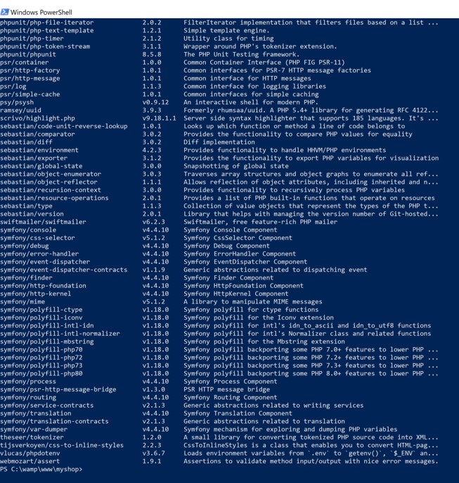

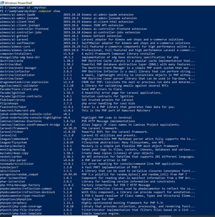

here is the out for: composer show

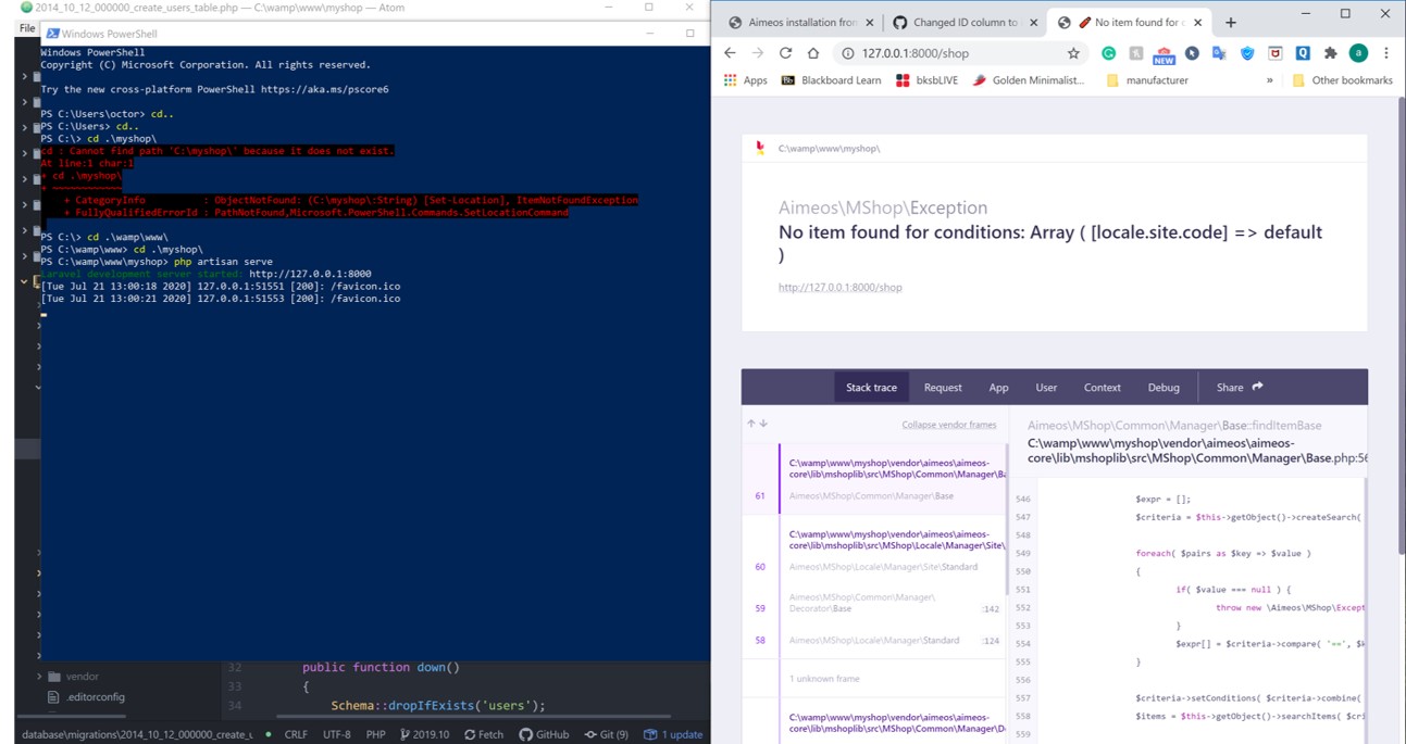

I don't know if this helps, but this is the error I get when opening the dev server of laravel,
Re: Aimeos installation from composer works but stop executing before database setup
If the setup doesn't run flawlessly, the application won't run at all.

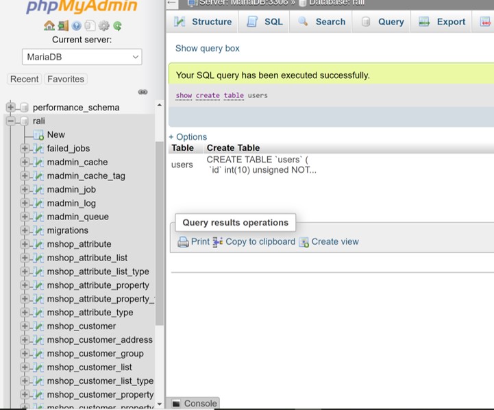

Can you please post the output of
from the mysql console?
show create table users;

this is the output on the sql command line
- 654654.jpg (79.07 KiB) Viewed 4412 times

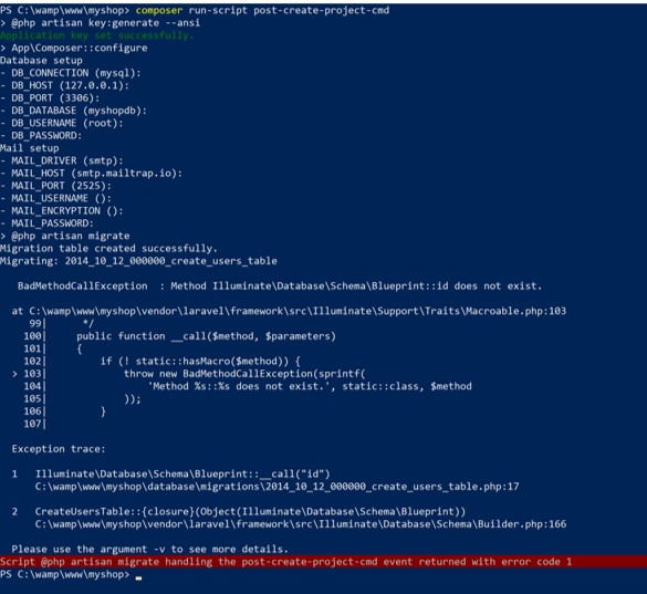

I ran the composer create-project aimeos/aimeos:2019.10.x-dev myshop a few times before and after changing my default engine but now it seems that the migrations are not running due to an exception. a pic can be seen below
