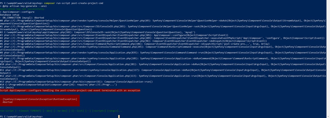

I am trying to install the aimeos Laravel package using Composer, the installation successfully creates the project but it fails to execute the command App\Composer::configure. after that, it doesn't allow me to set up the connection to the database through the command line. The errors I get are (also see image)
Script App\Composer::configure handling the post-create-project-cmd event terminated with an exception
[Symfony\Component\Console\Exception\RuntimeException]
Aborted
looking at the aimeos installation youtube tutorial, it seems that the connection step is important as after the connection is made, a few more dependencies are downloaded. if you have any advice please do let me know, thanks.

Re: Aimeos installation from composer works but stop executing before database setup
Strange! Can you add a try/catch method in this method and echo the stack trace of the exception when you run
Example code:
composer run-script post-create-project-cmdCode: Select all
try {
} catch( \Exception $e ) {
echo $e->getMessage() . PHP_EOL;
echo $e->getTraceAsString() . PHP_EOL;
throw $e;
In your mentioned App\Composer::configure() method.
octorber123
- Posts: 15
- Joined: 14 Jul 2020, 10:59
this is what i get when i put the try and catch block in that method.
- error.jpg (170.92 KiB) Viewed 8420 times

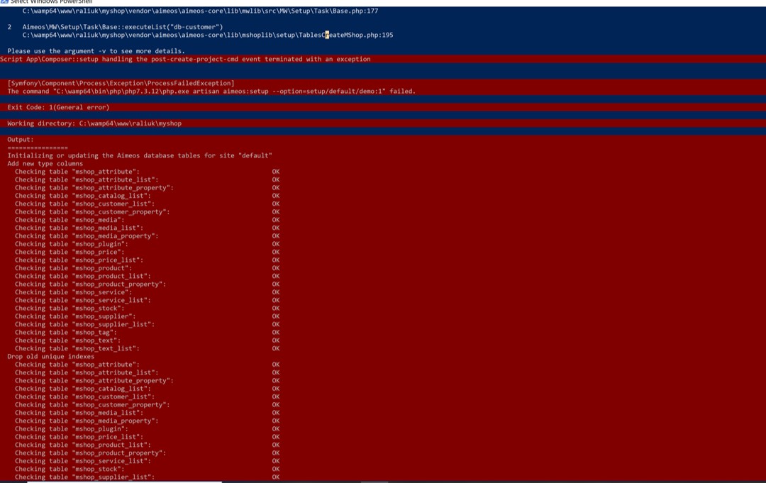

Hi, I have changed my PHP version from 7.4.0 to 7.3.12 and the DB connection step seems to continue working. However, on the final step I get an exception, the tables are created but the setup stops before allowing me to set up an account for the admin.
Thanks
The Laravel migration for the "users" table changed the "id" column from "int" to "bigint" to "int" between versions :-/
Can you please try the dev version instead:
And tell us if it works now?
composer create-project aimeos/aimeos:2019.10.x-dev myshopProfessional support and custom implementation are available at Aimeos.com
Tried that but it gives me the same error

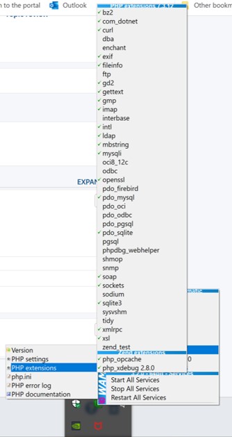

. Is possible that i am missing some php extensions? these are the extensions i have installed.
- Picture1.jpg (33.4 KiB) Viewed 8355 times
No, it's not a problem of PHP extensions but how the database reacts.
Can you please post the output of "composer show"?
