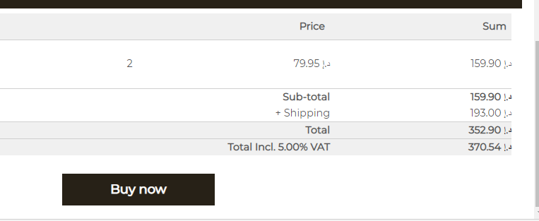

- this is summary
- summary.PNG (15.69 KiB) Viewed 3515 times

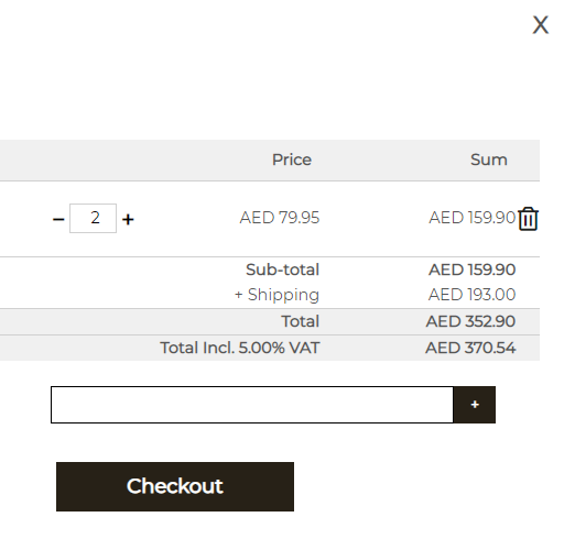

- this is basket image
- basket.PNG (18.36 KiB) Viewed 3515 times

My language id is 'en' and on that i have three different currency but when i click on buy it will automatically change the order to USD and save it , i also check basket on summary page its shows me currency id AED but after click on buy the order place in USD how can i resolve this issue ?
