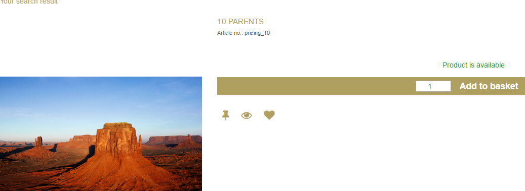

Hello, I downloaded the aimeos demo and working on it,
I'm trying to add new products with new images ,colors, width and length but the colors , width and length are not showing on the frontend.
Had anyone faced such problem?

What do you want to achieve? A selection product with variants or configurable attributes?
Your product will currently display the attributes in the "Characteristics" section on the product detail page

Hello Wassim,
I had the same problem. A change of the List type to "Configurable" should help.

Post by wassim.hattab » 20 Jul 2016, 09:32
Yes it worked when i added Configurable instead of Standard
