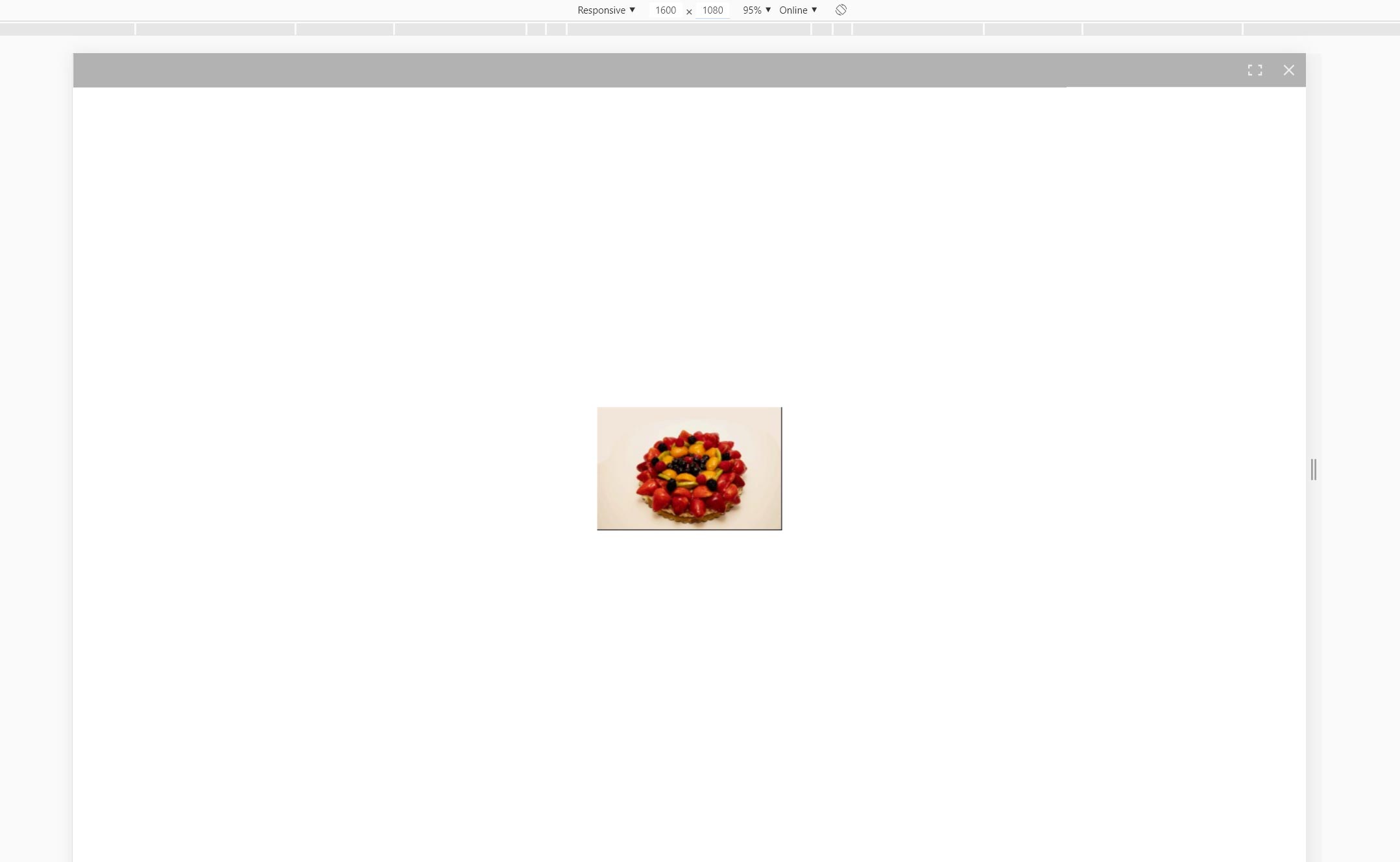

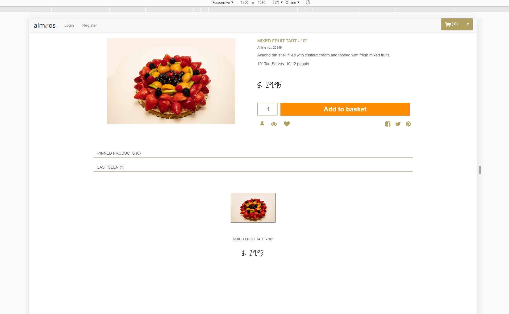

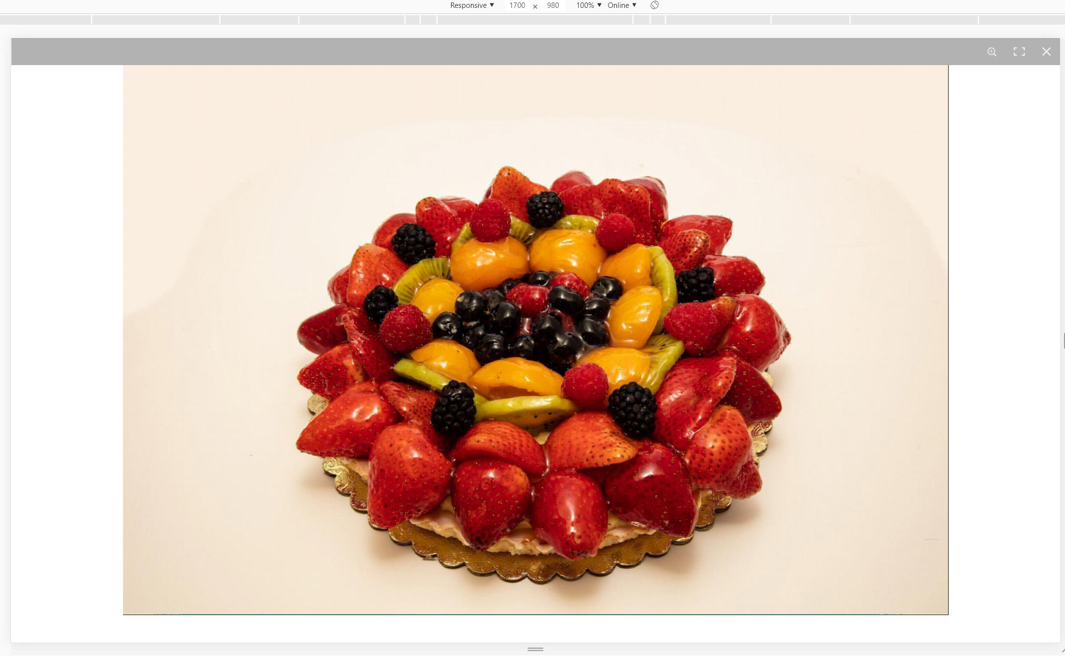

Clicking on the image on the product detail page (image 1) does not zoom in but instead renders a much smaller image (image 2) if the viewport is under about 1650px wide. If it is above this like 1700px the image zooms normally to fill the viewport. (image 3)

The crossover point seems to be a viewport of 1620px wide. I see there's reference to this size, At 1620px I get a large zoomed image. Drop the viewport down to 1619px and I get a 240px wide zoomed image. Mousing over the code (below) for that image shows "1619 X 1079 pixels (intrinsic 240 x 160 pixels)"
<img class="pswp__img" src="http://localhost:8000/preview/4/6/46fc6 ... 2948c6.jpg" style="display: block; width: 1619px; height: 1079px;">
Interestingly when i click on the above src link the image is the browser is still only 240px wide
