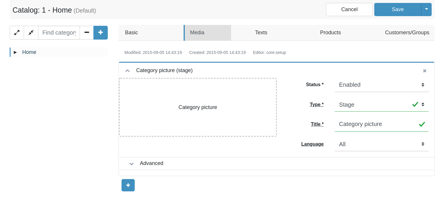

Hello!
I need to add image to each category, but it must be visible in category list?

goransabo wrote: 10 Apr 2021, 17:03 I need to add image to each category, but it must be visible in category list?
Use the catalog stage plugin and add an image to the category with type "stage".

1. Where and how I need to add category image?

goransabo wrote: 12 Apr 2021, 11:03 1. Where and how I need to add category image?
Add it here:
