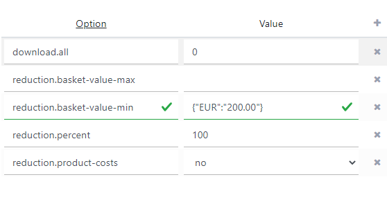

I think i dont understand the decorators right.
Can you tell me shortly with my examples they dont work, how the decorators have to work?
Two things i tryed. download.all 1/0 and weight.min 10. Both do nothing in frontend. i delted php - cache.
Option Value
download.all 1
weight.min 10
But frontend shows all delivery services like before.
BTW ow downloadproducts know they are downloadproducts? Only bcause they have an download ?
Now i have this frontenderror if i want to click to go to the checkout:
Argument 1 passed to Aimeos\MShop\Service\Item\Standard::getArrayValue() must be of the type array, string given, called in /home/users/username/www/Domainname/typo3conf/ext/aimeos/Resources/Libraries/aimeos/aimeos-core/lib/mshoplib/src/MShop/Common/Item/Config/Traits.php on line 85
Ps. i did give for sure the product an weight of 0, and its a downloadproduct. And setted for free shipping download.all 1 and for the dhl and so, "0"
Ps2. For sure i did read the different docus about before. But i dont understand, or something different wents wrong
Thanks. :)

Ps. I have this error not always, only by some products from the aimeos demos, i think. But maybe i changed there something. Please answer too about the decoratorquestion, or i didnt forget anything? :)
Im not sure if it make sence to tell another problem here: That always every to the basket added product is adding two times. it s possible to delete one then buts not good. Maybe its the same Root cause. I have no idea .
Is the stack trace the errorthing the full. here is a half of it. I hope its anough :)
Ps. Maybe because the 200€vallue, that would be dont make sence in one way, because its from aimeos but in other way: His 12 Products maybe over 200 and my AImeos products are all without the vouchers(and the vouchers make no problem) are 200€ or higher if two at the basket.

We can't reproduce the issue in our test environment but it has something to do with an invalid value entered in the admin backend. Can you post a screenshot of your service configuration that causes the problem?
Nevertheless, we've made a change in the Aimeos core that checks for invalid values and ignores them for now. If you use composer, you can run "composer up" to get the new aimeos-core release (20.10.22).

No i dont use composer. Symlink ^^
The only change i did made with this DHL Service i think , is i added download.all
Posts: 8647
Re: Decorators How they work and problems
Post by aimeos » 14 Apr 2021, 12:59
Can you add an empty object value for "reduction.basket-value-max" -> "{}" (without apostrophes)?
If i add
the result after saving is: []

Post by aimeos » 14 Apr 2021, 13:07
Doesn't matter. Does the error in the frontend still occur?

Post by Shopmister » 14 Apr 2021, 13:24
It seems the solution for this problem. I will see, but i testet 3 times in and not in and its always the same: if "[]" in the maxvaluefield all good and the field is empty the error :).
Okay,
and how in generel the service decorators work. BEcause download.all is false maybe and weight.min/max isnt working too. And i needed a very logn time to understand with the many dokus about the same, that i can use in the fields and not have to use the service decorators customer/lala/ ... = ...
And i dont understand the reduction and its dont working too i think, without the error but its do nothing :)
