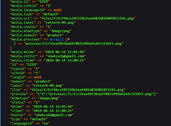

when i get the product media with this
$this->detailProductItem->getRefItems('media');
This data i am getting of media item
the type value become default.
Re: How to get product attribute type name
Post by aimeos » 04 Oct 2019, 08:21
The type code is part of all items that has a type column but not the type label.
