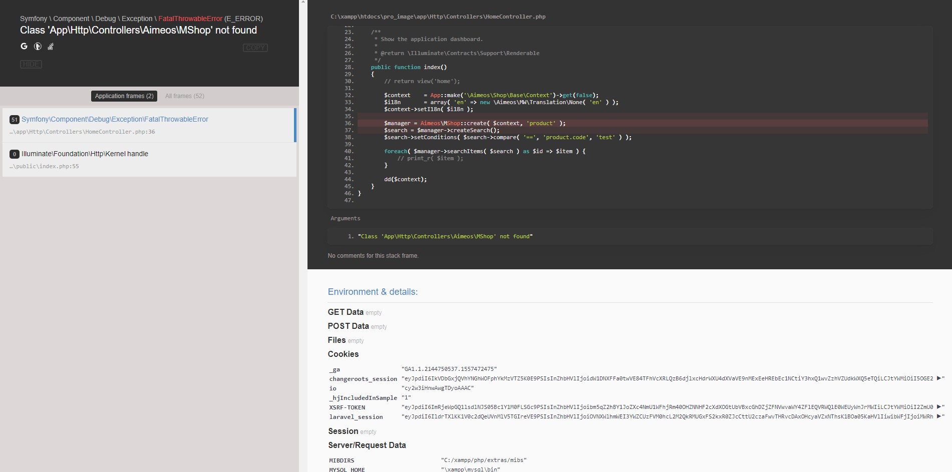

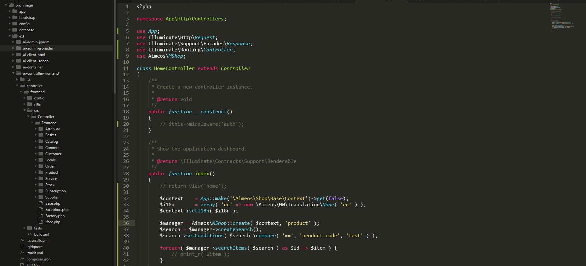

Thank you for your reply it means to lot for me here i have started work as per given instruction but having this error in aimeos version 2018.07 i have attached screenshots of my work. please help me on this.

- I'm getting error while using this
- Screenshot_3.jpg (86.3 KiB) Viewed 12559 times
- my HomeController code
- Screenshot_2.jpg (170.92 KiB) Viewed 12559 times

Re: Custom Module
Version 2018.07 isn't supported any more and you should use at least 2018.10. If you start from scratch, use 2019.04 or the upcoming 2019.07 because the posted code is for these versions.

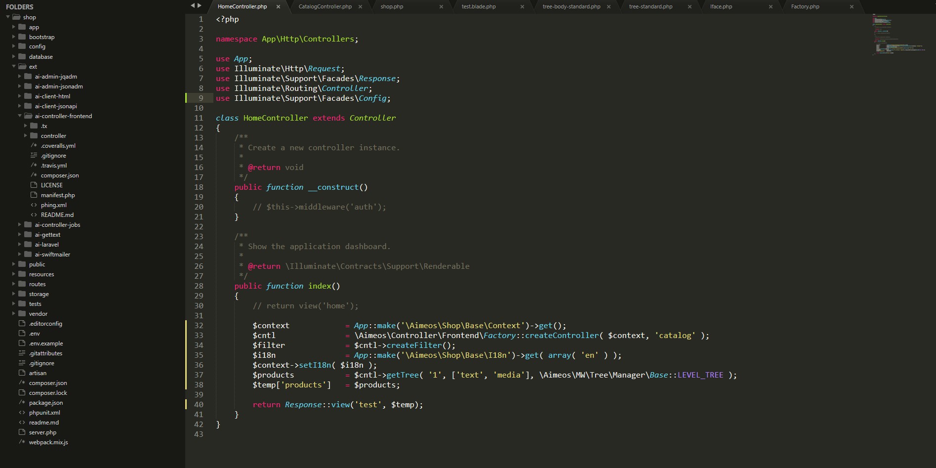

I have updated my aimeos version 2018.10 and now i have tried to get things as per your instruction and i get data from your side and have some questions. And i have done code in way is it proper way to do it.
1) How do i get target url of product or category
2) How can i use your class like view.php, Aimeos.php from vendor

- Screenshot_2.jpg (141.97 KiB) Viewed 12520 times
- Screenshot_1.jpg (173.42 KiB) Viewed 12520 times
Re: Custom Module

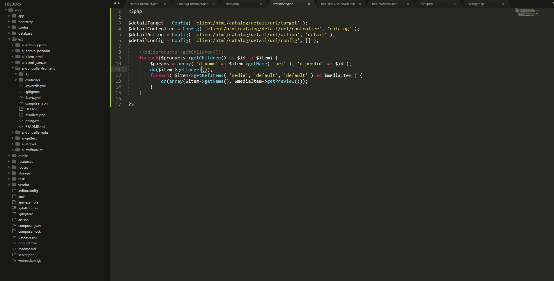

In your existing code where you use $this->config() to get the target, controller, action and url config:
$url = $this->url( $detailTarget, $detailController, $detailAction, $params, [], $detailConfig );Code: Select all
$enc = $this->encoder();
$enc->attr( $url );
$enc->attr( $this->content( $mediaItem->getPreview() ) );Don't know what you mean.kishanbupadhyaya wrote: 05 Jul 2019, 07:32 2) How can i use your class like view.php, Aimeos.php from vendor

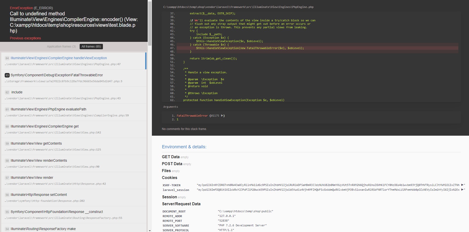

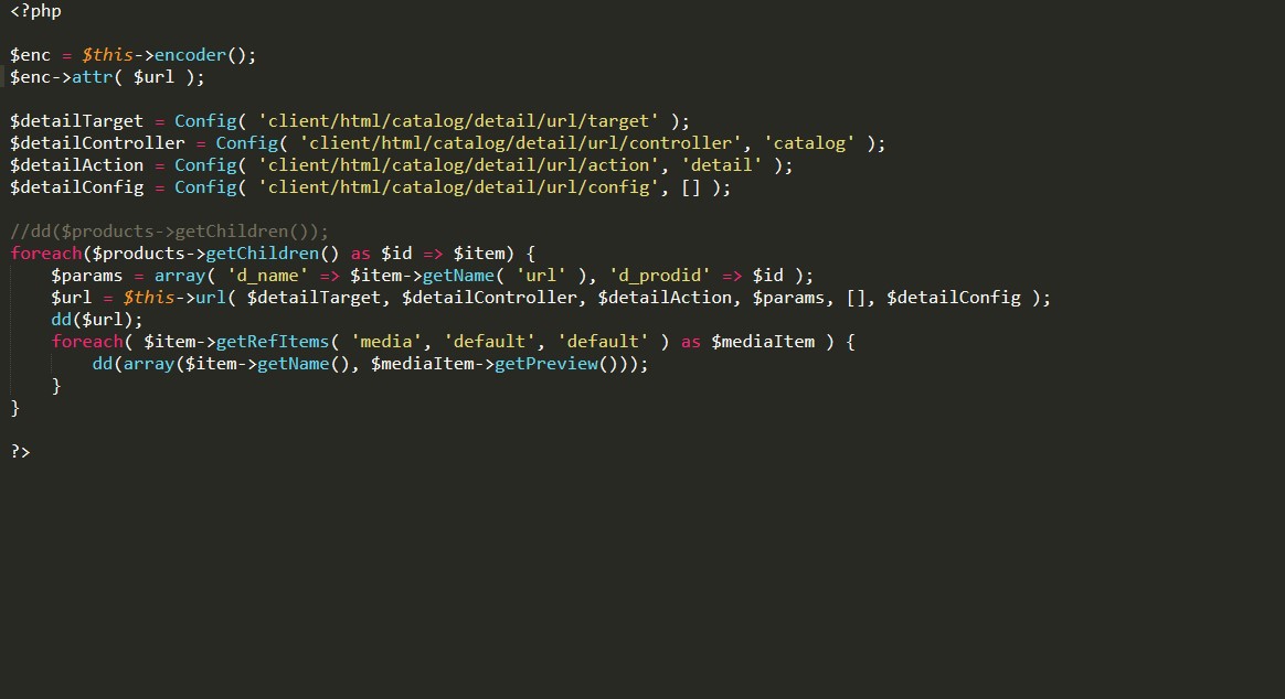

As per your instruction i have try to get url from category list but go this error.
Thank you,
Kishan Upadhyay
Thank you,
Kishan Upadhyay
- Screenshot_3.jpg (97.02 KiB) Viewed 12497 times
- Screenshot_2.jpg (247.08 KiB) Viewed 12500 times
- Screenshot_1.jpg (243.81 KiB) Viewed 12500 times
Re: Custom Module
If you want to use Blade templates, please read this article:
https://aimeos.org/docs/Laravel/Use_Blade_templates
Generate URLs by using the Laravel route() method.
