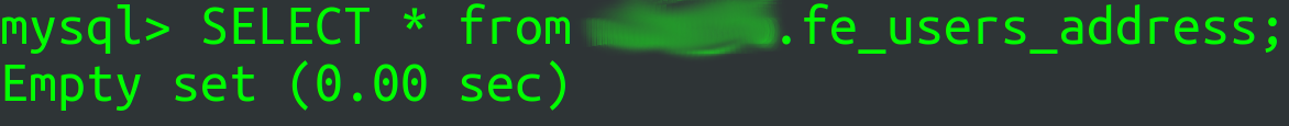

Re: Couldn't edit frontend user data with 'Aimeos Shop - Account profile' content element
Maybe it's a problem with the siteid. Guess the value of the "siteid" column is empty for that record in fe_users but is that also the case for the corresponding fe_users_address entry?niklas-doerner wrote: 17 Aug 2020, 20:13Code: Select all

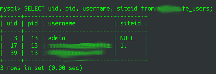

Hey,
as you see the fe_users_address is empty.
At the other screenshot you see that the pid is taken correctly in plugin.tx_aimeos.settings.mshop.customer.manager.typo3.pid-default = 13
The user with the uid 17 is the user created at the end of the checkout process. Unlike to the user 39, which is created with another extension for user registration.
Can you please set
and open the account profile page in your browser? Then, have a look at the Log panel in the admin backend or into the madmin_log table and search for the SQL that retrieves the data from fe_users. Can you post that statement please?
Yes. The user with uid 39 should be found and his data displayed in the account profile component because
matches siteid "1." and an empty siteid which is the case for that user.
( ( t3feu."siteid" = '1.' OR t3feu."siteid" = '' ) AND ( t3feu."uid" = 39 AND t3feu."disable" = 0 ) ) AND t3feu."deleted" = 0Professional support and custom implementation are available at Aimeos.com
