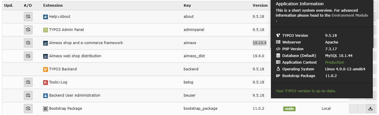

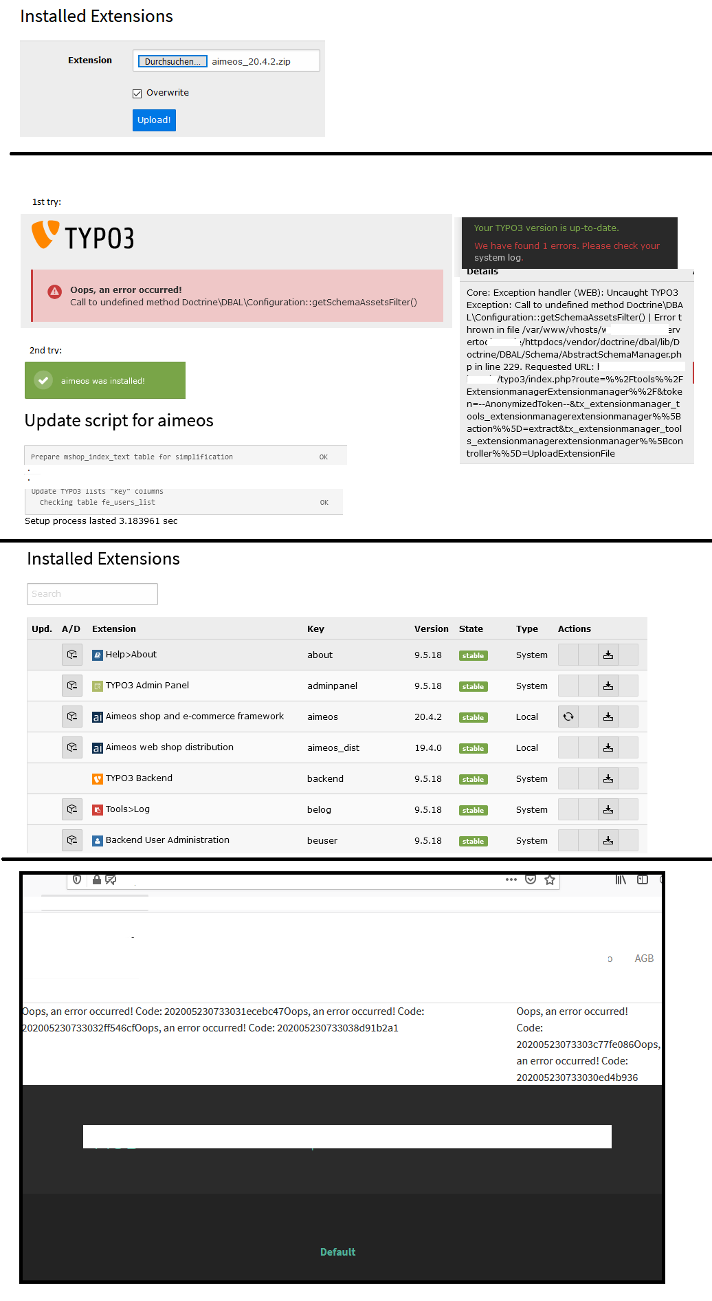

Start situation:
i try to Update from 19.10.4 to 20.4.2 like you wrote in the manual.
The Extension Upload+Overwrite showed this exception on first try:
Call to undefined method Doctrine\DBAL\Configuration::getSchemaAssetsFilter()
Core: Exception handler (WEB): Uncaught TYPO3 Exception: Call to undefined method Doctrine\DBAL\Configuration::getSchemaAssetsFilter() | Error thrown in file /var/www/vhosts/webXXX.linus.sXXXXXXX.de/httpdocs/vendor/doctrine/dbal/lib/Doctrine/DBAL/Schema/AbstractSchemaManager.php in line 229. Requested URL: https://XXXXXXXXXX.XX/typo3/index.php?r ... ensionFile
then i run the script (circular button), script shows everything "ok" and "done", no errors.
if i Upload + Overwrite again, then the "getSchemaAssetsFilter" error not showing up again and the upload seems to be ok.
Then again circular button.

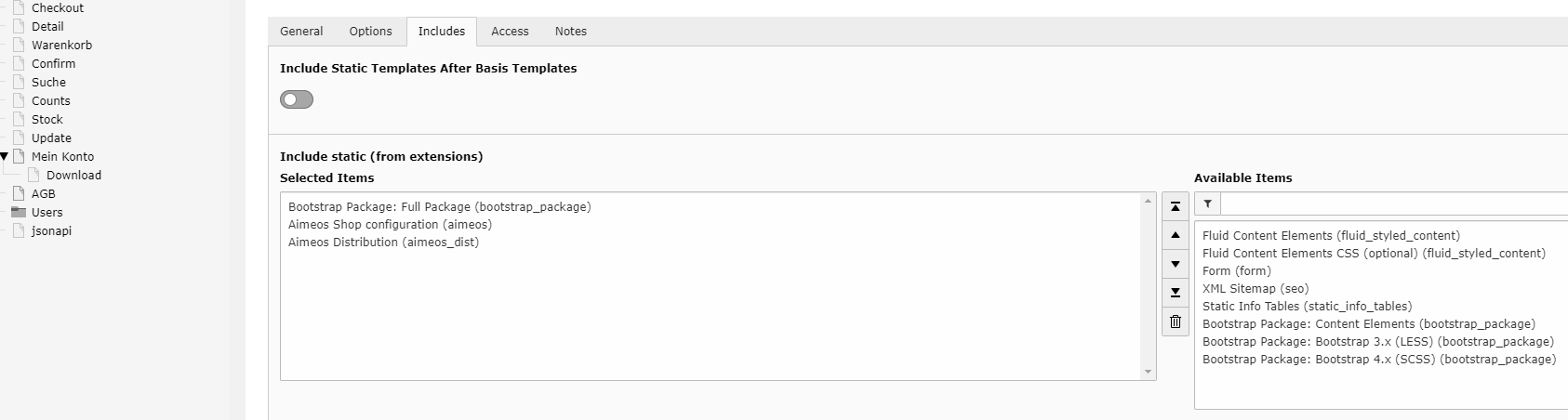

then i Remove the Aimeos extension template from the root template and add it again, like described.
But mine was looking like this ( i used the preconfigured aimeos typo3 extension when i installed it first time):

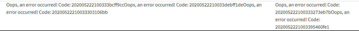

Then i get this errors on my page, instead of the shop menu:
if i edit the template and remove the
Bootstrap Package and Aimeos Distribution (aimeos_dist) from the template and leave only Aimmeos Shop configuration (aimeos) then this errros appears in the backend log:
LIVE ERROR Error handler Core: Error handler (FE): PHP Warning: fopen(/var/www/vhosts/weXXXX.liXXX.XXXX.XX/httpdocs/typo3temp/var/lock/flock_b3b32a2d422265cd25c3323ed0157f81): failed to open stream: No such file or directory in /var/www/vhosts/weXXXX.liXXX.XXXX.XX/httpdocs/typo3/sysext/core/Classes/Locking/FileLockStrategy.php line 97
20:08:33 [0]
LIVE ERROR Error handler Core: Exception handler (WEB): Uncaught TYPO3 Exception: #1518472257: Failed to fetch error page "https://XXXXXXXX.XX", reason: Server error: `GET https://XXXXXXXX.XX` resulted in a `500 Internal Server Error` response: <!DOCTYPE html> <head> <meta http-equiv="Content-Type" content="text/html; charset=utf-8"> <meta name="robots" cont (truncated...) | RuntimeException thrown in file /var/www/vhosts/weXXXX.liXXX.XXXX.XX/httpdocs/typo3/sysext/frontend/Classes/Controller/ErrorController.php in line 210. Requested URL: https://XXXXXXXX.XX/index.php?id=13&L=0 ... %5D=detail
20:08:33 [0]
LIVE ERROR Error handler Core: Exception handler (WEB): Uncaught TYPO3 Exception: #1294586099: Lock file could not be opened | TYPO3\CMS\Core\Locking\Exception\LockAcquireException thrown in file /var/www/vhosts/weXXXX.liXXX.XXXX.XX/httpdocs/typo3/sysext/core/Classes/Locking/FileLockStrategy.php in line 99. Requested URL: https://XXXXXXXX.XX/
20:08:33 [0]
LIVE ERROR Error handler Core: Exception handler (WEB): Uncaught TYPO3 Exception: #1294586099: Lock file could not be opened | TYPO3\CMS\Core\Locking\Exception\LockAcquireException thrown in file /var/www/vhosts/weXXXX.liXXX.XXXX.XX/httpdocs/typo3/sysext/core/Classes/Locking/FileLockStrategy.php in line 99. Requested URL: https://XXXXXXXX.XX/index.php?id=13&L=0 ... %5D=detail
20:08:33 [0]
20:08:33 [0]
20:08:33 [0]
20:08:33 [0]
20:08:33 [0]
20:08:33 [0]
20:08:33 [0]
LIVE ERROR Error handler Core: Exception handler (WEB): Uncaught TYPO3 Exception: #1518472257: Failed to fetch error page "https://XXXXXXXX.XX", reason: Server error: `GET https://XXXXXXXX.XX` resulted in a `500 Internal Server Error` response: <!DOCTYPE html> <head> <meta http-equiv="Content-Type" content="text/html; charset=utf-8"> <meta name="robots" cont (truncated...) | RuntimeException thrown in file /var/www/vhosts/weXXXX.liXXX.XXXX.XX/httpdocs/typo3/sysext/frontend/Classes/Controller/ErrorController.php in line 210. Requested URL: https://XXXXXXXX.XX/robots.txt
20:08:33 [0]
20:08:33 [0]
19:57:30 [0]
19:57:56 [0]
20:08:33 [0]
LIVE ERROR Error handler Core: Exception handler (WEB): Uncaught TYPO3 Exception: #1395140007: Cannot create directory /var/www/vhosts/weXXXX.liXXX.XXXX.XX/httpdocs/typo3temp/var/lock/ | TYPO3\CMS\Core\Locking\Exception\LockCreateException thrown in file /var/www/vhosts/weXXXX.liXXX.XXXX.XX/httpdocs/typo3/sysext/core/Classes/Locking/FileLockStrategy.php in line 65. Requested URL: https://XXXXXXXX.XX/
20:08:33 [0]
LIVE ERROR Error handler Core: Exception handler (WEB): Uncaught TYPO3 Exception: #1395140007: Cannot create directory /var/www/vhosts/weXXXX.liXXX.XXXX.XX/httpdocs/typo3temp/var/lock/ | TYPO3\CMS\Core\Locking\Exception\LockCreateException thrown in file /var/www/vhosts/weXXXX.liXXX.XXXX.XX/httpdocs/typo3/sysext/core/Classes/Locking/FileLockStrategy.php in line 65. Requested URL: https://XXXXXXXX.XX/index.php?id=1
20:08:33 [0]
LIVE ERROR Error handler Core: Exception handler (WEB): Uncaught TYPO3 Exception: #1395140007: Cannot create directory /var/www/vhosts/weXXXX.liXXX.XXXX.XX/httpdocs/typo3temp/var/lock/ | TYPO3\CMS\Core\Locking\Exception\LockCreateException thrown in file /var/www/vhosts/weXXXX.liXXX.XXXX.XX/httpdocs/typo3/sysext/core/Classes/Locking/FileLockStrategy.php in line 65. Requested URL: https://XXXXXXXX.XX/index.php?id=1&ai%% ... n%%5D=list
20:08:33 [0]
19:57:37
xxxx_xxxxxxxxxxx
19:57:37
xxxx_xxxxxxxxxxx
if i add the Bootstrap Package and the aimeos_dist back again to the template then this error coming back when i try to load my page:
At the moment i restored my backup and back to 19.10.4.
Can you help me maybe please to update?

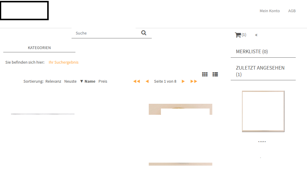

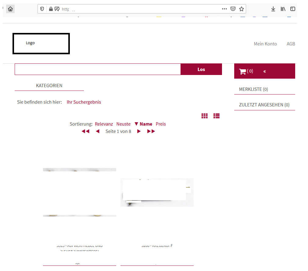

After i added the configuration, the page loaded! but didnt loaded like it should be:
(the articles are not shown, i can open the categorys but they are empty.) In typo3 backend the articles still there and are assigned to the categorys.)

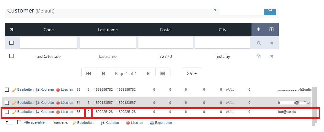

if i create a new customer now, the only difference is the "pid" number. Usually it was always 3... now its 0 for a new customer.

db users:
added new user after update:
added new customer.png (25.47 KiB) Viewed 9783 times

bouuman wrote: 23 May 2020, 09:47 After i added the configuration, the page loaded! but didnt loaded like it should be:
Rebuild the Aimeos index using the scheduler.
bouuman wrote: 23 May 2020, 09:47 customers menu is empty but they still visible in the database fe_users:
Not sure about why the customer menu is empty if you have entries in your fe_users table.
If you want to create customers in the Aimeos backend, you have to configure the page ID so they are able to log in (https://aimeos.org/docs/TYPO3/Install_A ... etup_login):
plugin.tx_aimeos.settings.mshop.customer.manager.typo3.pid-default = 3
module.tx_aimeos.settings.mshop.customer.manager.typo3.pid-default = 3
But the best place is to configure this in the PHP config file in your own extension because then it's available in the frontend, backend and the scheduler without having several configurations. Add it to <yourext>/Resources/Private/Config/mshop.php:

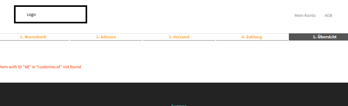

missing customers, i can log in the customers because they still in the database but when you try to checkout then this comes up:

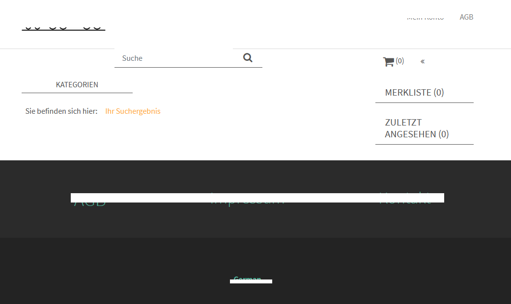

the products appears again after i updated the index via sheduler like you told me thank you,
but Layout and formats of the homepage are gone, it looks strange formated now:
bouuman

bouuman wrote: 23 May 2020, 12:46 missing customers, i can log in the customers because they still in the database but when you try to checkout then this comes up:
Can you please check the siteid column in the fe_users table? It should now contain for your records something like "1." if there's a mshop_locale_site.id record with ID 1 or it can be empty string but NOT NULL.
bouuman wrote: 23 May 2020, 12:46 the products appears again after i updated the index via sheduler like you told me thank you,
The theme has been updated and it differs from the 2019.x version, so you have to adapt it if you have already changed it to your own layout.
