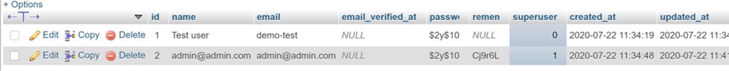

octorber123 wrote: 22 Jul 2020, 11:44 only one problem tho, I set up the admin account during setup, however when I log in i can't access the backend, it seems that it is treating me like a customer, how can I fix that?
Can you post the record from the users table?

here is the users table

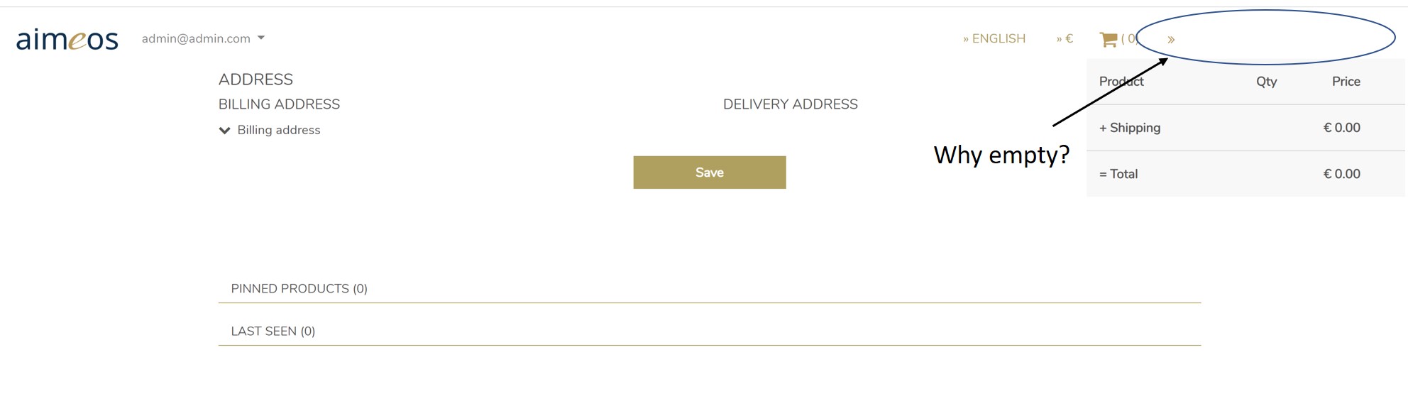

This is the first page i see when i log in as an admin, also why is the area highlighted empty?

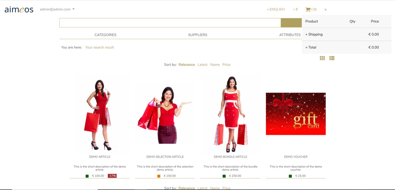

this is the front page (again you can see that area is empty

Everything seems to be OK. To go to the admin backend, you have to explicitely use the /admin URL in your browser. If you use the Laravel login link, you will only get redirected to the profile page because admins are also regular users.
The empty area right of the small basket symbol is due to sliding in the small basket content.
