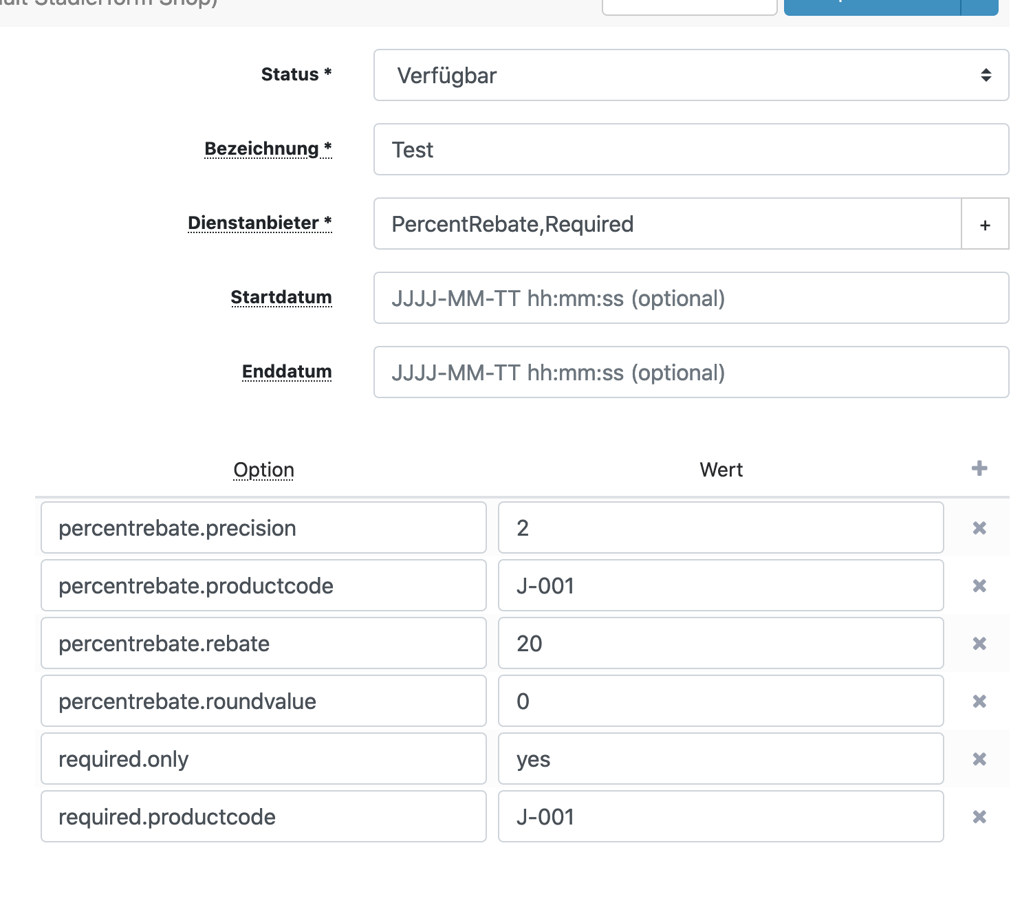

Hey Admin,
Thank you for your reply. We are not on the most recent version. See attachment. Any possibility to realize what I describe in my first post? To use required.productcode on defined products only?
Best regards
Samuel

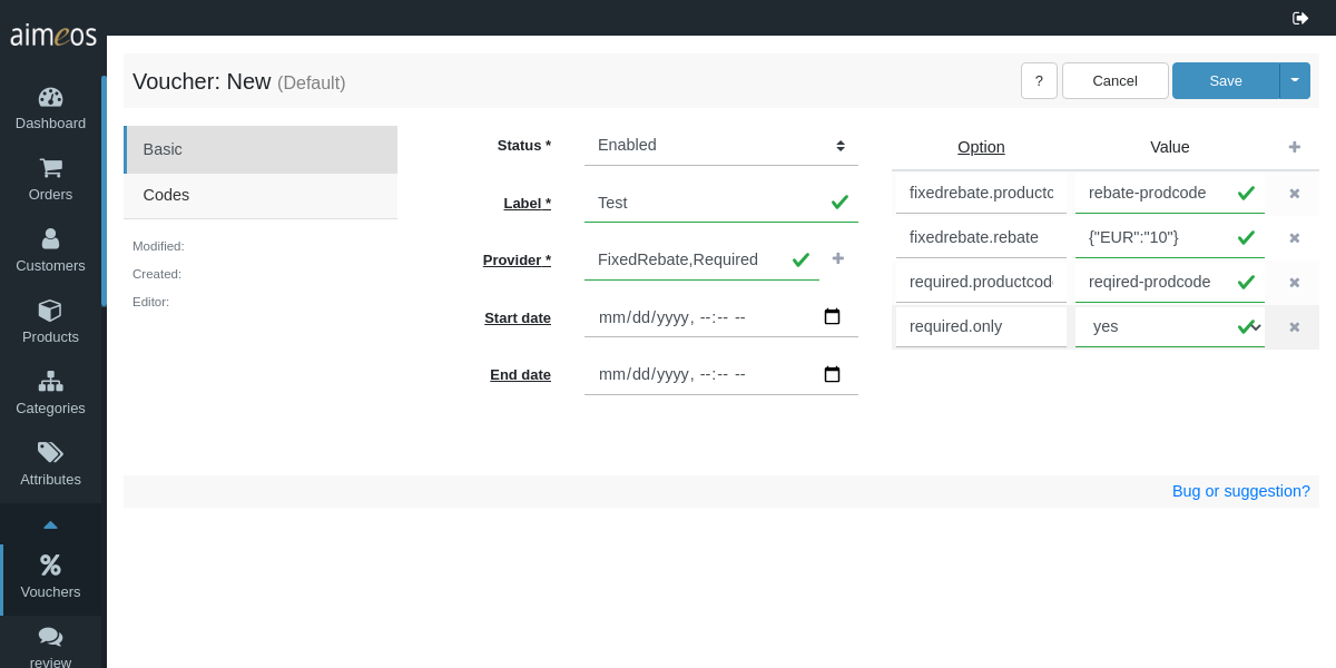

Re: required.productcode - Bug?
Your configuration must look like (replace "rebate-prodcode" and "required-prodcode" with the product codes of the rebate product and the requried product):
Thank you for your quick answer.
I reconstructed your advice - with the difference, that I used percentrebate.....
So currently the code only works, when the product (in this case J-001) is in the basket. However, if I add another product, (J-002) for example, the rebate is added on the product, too. But my target is to only discound J-002, no other prodcut in the basket.
Am I missing anything?
Thank you in advance for your feedback!
Cheers
Cheers
- screenshot.png (167.81 KiB) Viewed 57912 times

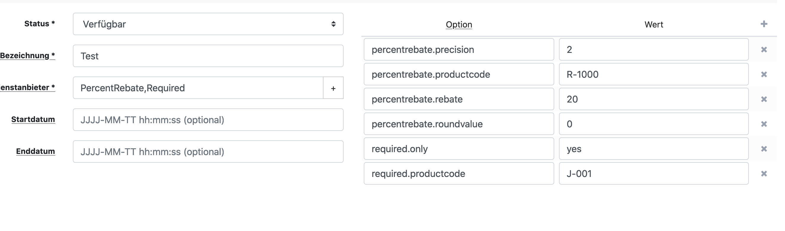

Hey Admin,
Great on you. Thank you. First problem resolved. I now understood the point about the rebate product code. This is changed and now displayed correctly in check out. However, whta is not yet working properly is the required.only = yes.
If I add any other product (beside J-001) - the rebate applies on the other product, too.
It should be as follows
J-001 with 20 % rebate
P-001 no rebate
D-002 no rebate
See my current configuration (R-1000) is the 20% Rebate product code.
I am sure, I am missing a point and you can tell me which one.
Tks!
P-001 no rebate
D-002 no rebate
Tks!
- screenshot.png (169.34 KiB) Viewed 57904 times
