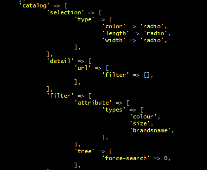

There's a config option to change that behavior:
https://aimeos.org/docs/2022.x/config/c ... e-search_1

adding this line did not give a result. the search works only by category. the product located in the DZIECKO category by search will be visible only from the main page (where the search works for all categories), or in the DZIECKO category itself. in other categories, this product will not be found, because the search in them is limited only to this category.
how to set up a search so that it searches for products in all categories, and not in the one where you are now?

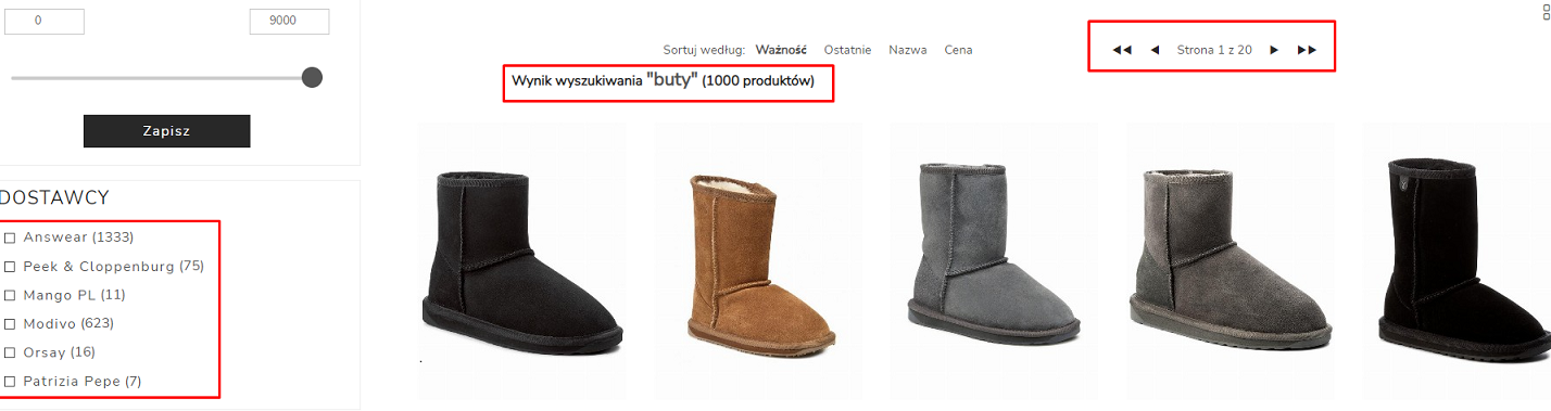

how can I change the limit on the number of pagination pages and the number of products found?
