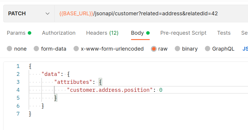

Good evening, I want to change customer.address.position in the patch request aimeos jsonapi but it doesn't work.
I did a direct search of ai-client-jsonapi and aimeos/core source code to learn how the process of patch request works. All I get is confusion. I ask for your help to add a feature to change customer.address.position in the patch request. Thank you and consider.
- Screenshot from 2022-07-03 17-32-51.png (42.62 KiB) Viewed 3005 times

Re: Request for new feature
The PATCH method for the basket/address resource is brand new and will be available in 2022.07+
Furthermore, you won't be able to change a single field like "order.base.address.position" because Aimeos supports adding several addresses. Instead, you have to pass the complete billing or delivery address(es) to the JSON API and it will remove the existing ones first and add the new ones afterwards - just like the new PATCH method for basket/service.
