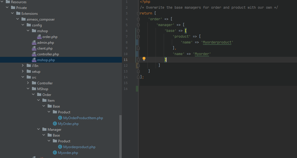

Hi Aimeos-Team,
i have extended the order-manager and order-product-manager to add some data to the objects, as you can see in the screenshot. That had worked in Version 22.4.x.
But in 22.7.1 in the frontend the message appears.
What i am doing wrong?
Class "\Aimeos\MShop\Order\Manager\Myorder" not foundWhat i am doing wrong?
- 2022-09-16 09_38_02-Greenshot.png (31.28 KiB) Viewed 2727 times
Thanks a lot!
Re: Extending Managers in 22.7.x
Please update to the newly released 22.7.2 version, which should fix the problem.
