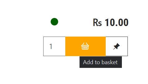

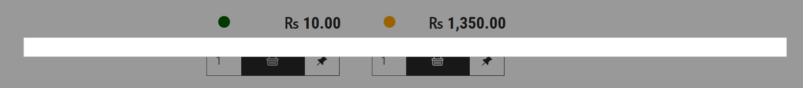

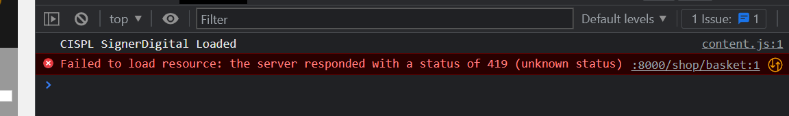

Hi
"php": "^8.0.10", "aimeos/ai-payments": "^2022.10","aimeos/aimeos-laravel": "^2022.10",
"laravel/framework": "^9.2", "omnipay/stripe": "^3.2", OS: Linux
When we click on add to basket button, we are getting 419 error, but it's working after we logged to the portal. this issue happens randomly when without logging in. please assist me with this. attached is the screenshot. Thank you

HTTP status 419 is used by Laravel to indicate that the CSRF token is not sent or invalid.
Did you change the template?

Most likely, an old CSRF token is sent to the server when adding a product to the basket. Caching could be a problem and you can disable it in your ./config/shop.php ("madmin" section) for testing.

if I disable madmin section, no error is appearing but the site loses performance. Thank you

Found the problem (a wrong key for replacing the CSRF tokens). Can you please install the -dev version, enable caching and test again?
composer req aimeos/ai-client-html:2022.10.x-dev

Thank you! its working now
