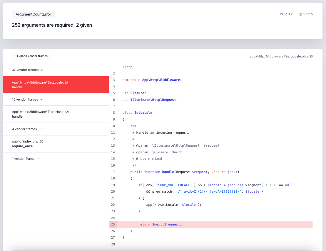

I just enabled the paypal express and all seems working fine, after the 5th ( summary ) step of checkout, once clicked at "Buy now" button it is throwing ArgumentCountError (252 arguments are required, 2 given) from Middleware/SetLocale.php
please check attach error log images.

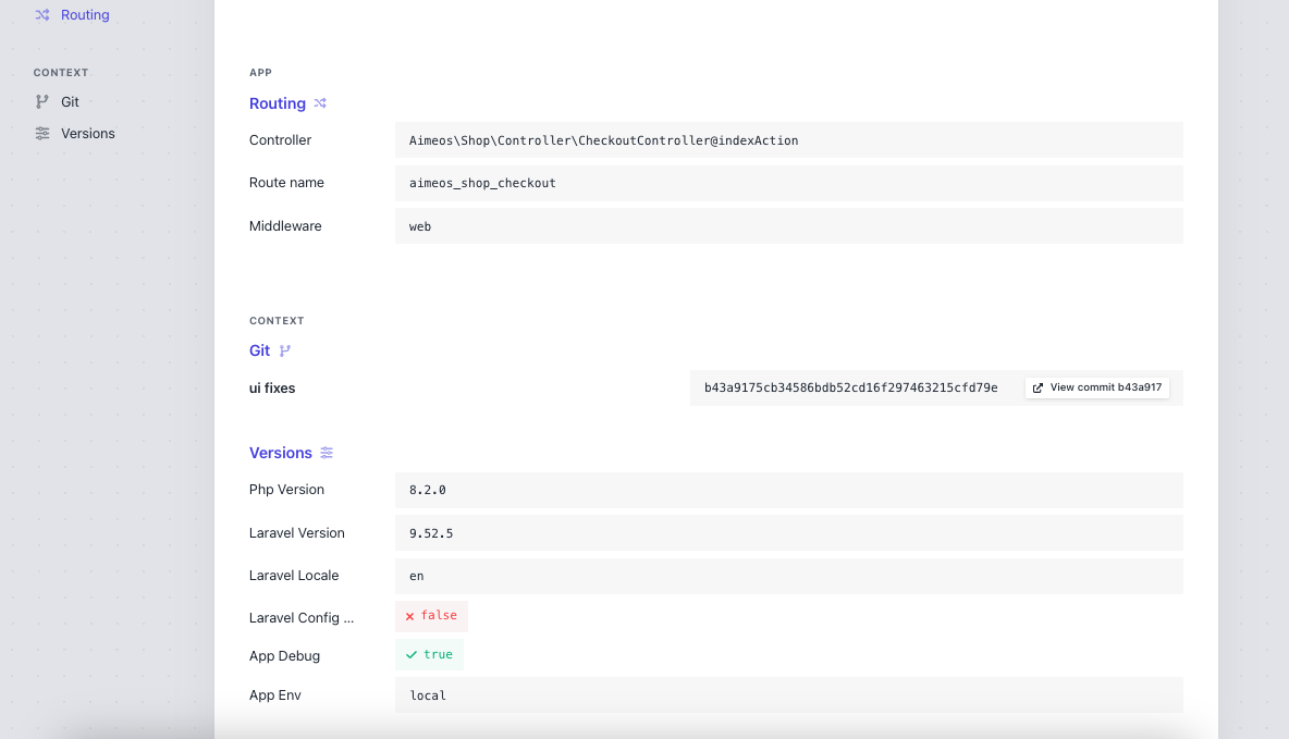

- versions
- Screenshot 2023-05-31 at 10.27.00 AM.png (69.34 KiB) Viewed 6653 times
- error-log
- Screenshot 2023-05-31 at 10.26.48 AM.png (120.17 KiB) Viewed 6653 times

setLocale() is not the problem, click on "Expand all vendor frames" to see the last 2-3 entries

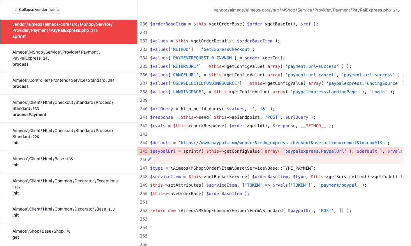

here is "Expanded all vendor frames" with some last logs
- expanded logs
- Screenshot 2023-05-31 at 7.29.17 PM 2.png (86.48 KiB) Viewed 6637 times
Re: route aimeos_shop_checkout throwing ArgumentCountError
Check the "paypalexpress.PaypalUrl" value in Setup > Services > PayPal in the admin backend. It seems like it's value is wrong and you can remove the complete line so the default value will be used again.

Dear,
Thanks for support and replying.
The value for the "paypalexpress.PaypalUrl" that I was using was "https://www.sandbox.paypal.com/webscr&c ... ken=%251$s"
as I was integrating according to the sandbox level configuration.
deleted this line and got the default value as "https://www.paypal.com/webscr&cmd=_expr ... token=%1$s"
and it is working now.
all other values like
- paypalexpress.ApiEndpoint
- paypalexpress.ApiSignature
- paypalexpress.ApiUsername
are according to sandbox environment.
