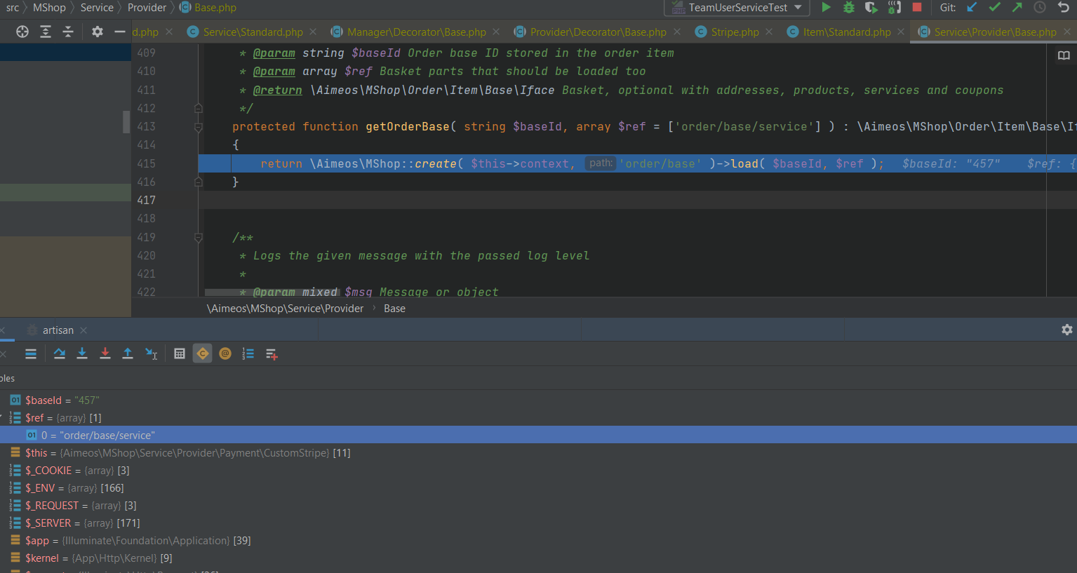

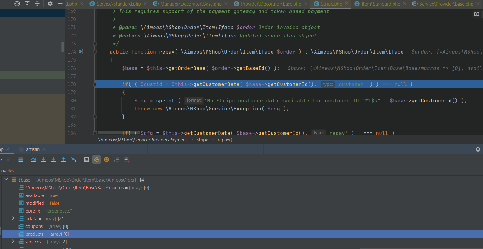

it also seems to me that I found a bug in the repay process for the Stripe provider, the price for the order will not take into account the price of the products, since only 'order/base/service' is set in the $ref for the getOrderBase method
if so, I can make a pull request with a fix

Post by aimeos » 12 Aug 2023, 09:40
If you think you've found a bug, please create an issue or an PR in the Github repository :-)
