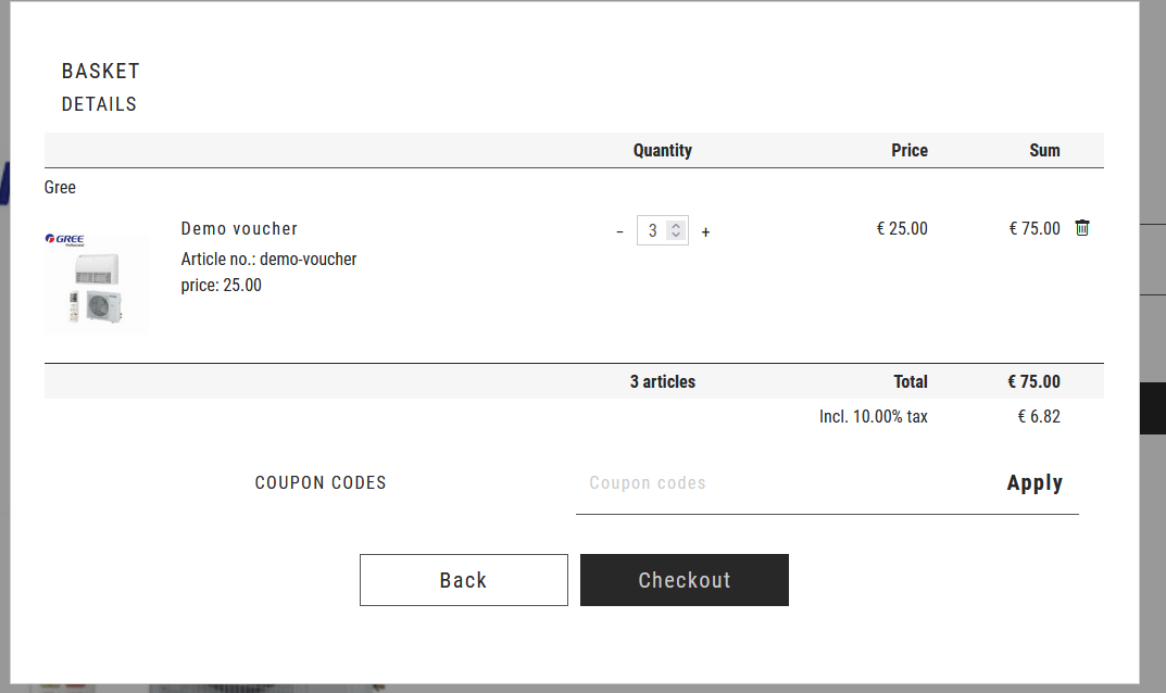

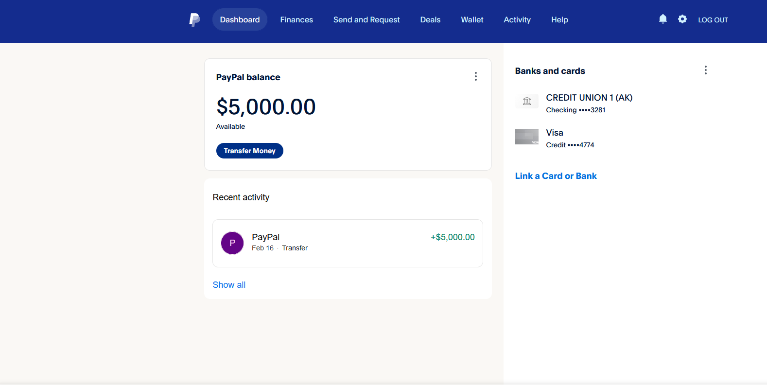

Hello everbody , i am trying to integrate the paypal payment
i have added all the field in dashboard , with the sandbox details but i try to do the checkout
i got redirect to the paypal account dashboard and no payment is made here is the photos .

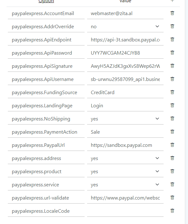

From your screenshots it's not possible to see what the problem could be. Can you please add a screenshot from the configuration of the service item for the PayPal payment option?

here is the configuration
Re: PayPal integrate
Post by aimeos » 19 Feb 2024, 08:07
Looks OK. Did you use the PayPal NVP credentials (not the one for the REST API)?

yes i used :NVP/SOAP Sandbox API credentials , the idea is the after i add paywith paypal the windows goes direct to paypal dashboard and nothing happen
Post by aimeos » 19 Feb 2024, 08:29
The paypalexpress.PaypalUrl setting is wrong and must be:
https://www.sandbox.paypal.com/webscr&cmd=_express-checkout&useraction=commit&token=%1$s

Post by webmaster » 19 Feb 2024, 08:57
thanks bro that helped me a lot.
