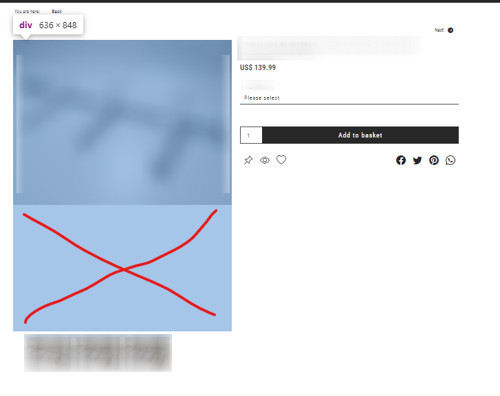

But now I am having a problem with a lot of padding between my product images and the thumbnail previews of the other images below it. It seems to be due to this style getting applied: --ai-product-image-ratio: 3 / 4;
If I manually change this style in my Chome Developer tools it fixes the issue: --ai-product-image-ratio: 4 / 3;
What is determining that aspect ratio? My image is 800px X 604px.
I am not sure how to properly correct this. I attached a sample of the product display to this post.

I did find that I have aimeos.css copied into my custom theme directory, I found and changed the value there:
Should I be hard coding this? What if I have some images that are 4/3 and some that are 3/4?

If you have both, portrait and landscape images, then it's indeed difficult as the Swiffy slider implementation works best if you have a predefined ratio between width and height. You can try to unset that ratio in the CSS and see if it works for you.
