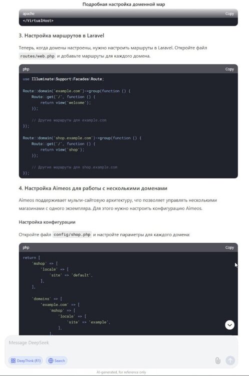

A whole week of different experiences in the evenings on real and virtual servers (Open Server Panel 6). Dozens of different reinstalls. Lots of read instructions. I even studied the certificate system for an entire subdomain area (hello wildcard WC).
Appeals to AI...

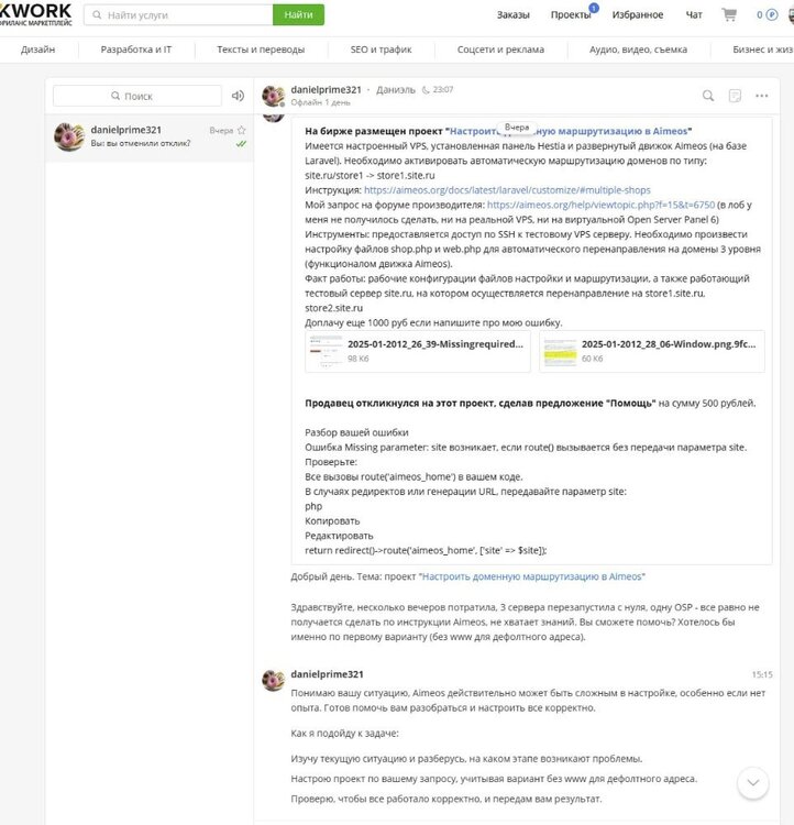

I even posted a task on the freelancers exchange - they tried to help, I gave them access to the test server - but they didn't succeed either.
I'm already desperate. Allow me to reinstall the server, install the Hestia control panel, install apache2, Nginx (PHP-FPM) and MariaDB.

We don't know HestiaCP and the trouble you are having but we recommend a standard setup with Apache/Nginx, PHP-FPM and MySQL/MariaDB.
ЕвгенияСемихова(ИПСемиховаЕ.А.) wrote: 30 Jan 2025, 15:36 UPD_2: can anyone say: why Russian's biggest marketplace (ozon) use URL like "site.com/seller/shop_name-id****/main_item_catalog/" ? Not simple, I think. Hmm, maybe the author of the aimeos software product did not just simple make the default addressing of stores in the catalog after the domain? Maybe this would be a better solution? Please help me decide.
Using the seller as part of the URL path is the standard setup:
yourdomain.com/shop/seller1
Alternative using subdomains:
seller1.yourdomain.com/shop
Alternative using custom domains:
seller1.com/shop
Documentation: https://aimeos.org/docs/latest/laravel/ ... he-routing

big thanks for this unical system!!! I win it!
My errors:
1) don't need any Control Panel!!! Yes, it is very simple for every days, but not working right!!!
Yes, you are right!!! Only clear OS by own hand's installin package!
2) I have only add to "shop.php" only recommended "'domain' => '{site}', ", but not cut others {site} includings!!! - it is simple to view, when write command "php artisan route:list" and see at listing!!!
3) need to write at admin panel right url of stores!!! Or write right store's name when add it by artisan comand!
So, now all working:
