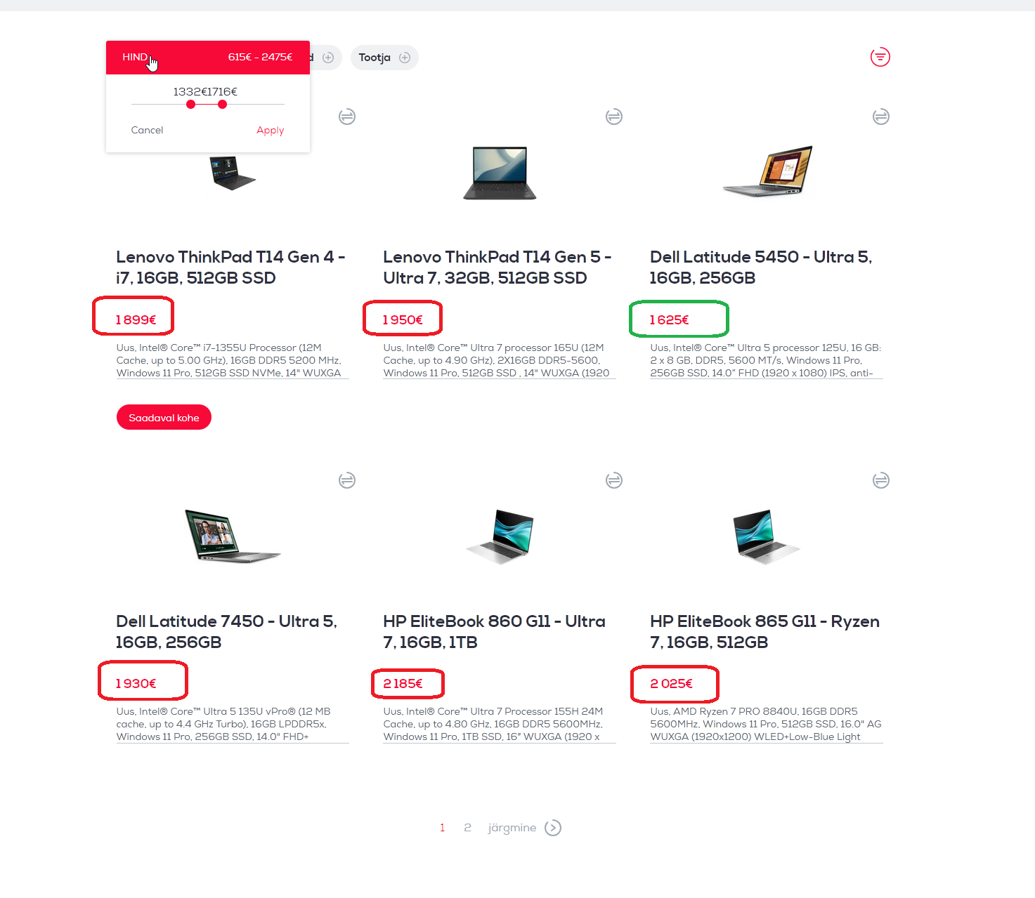

Ok, I have played around with prices a bit.
I would say, that min price works, max price works, but range filter does not work.
Raw URL:
https://aimeos.priit.yt.lan/jsonapi/product?include=attribute%2Cmedia%2Cprice%2Cproduct%2Cproduct%2Fproperty%2Ctext%2Ccatalog%2Csupplier%2Cstock%2Cproperty%2Cproduct%2Fproperty%2Ftype%2Cattribute%2Ftype&page%5Blimit%5D=6&page%5Boffset%5D=0&filter%5B%26%26%5D%5B0%5D%5B%3E%5D%5Bindex.price%3Avalue%28%22EUR%22%29%5D=1332&filter%5B%26%26%5D%5B0%5D%5B%3C%5D%5Bindex.price%3Avalue%28%22EUR%22%29%5D=1716
Decoded
/jsonapi/product?include=attribute,media,price,product,product/property,text,catalog,supplier,stock,property,product/property/type,attribute/type
&page[limit]=6
&page[offset]=0
&filter[&&][0][>][index.price:value("EUR")]=1332
&filter[&&][0][<][index.price:value("EUR")]=1716
It should return products that are priced between 1332 and 1716 EUR, but it returns products that are visible on the picture:
Am I doing something wrong or is this a bug?

matish wrote: 26 Nov 2025, 17:18
&page[limit]=6
&page[offset]=0
The filter part has wrong indexes and must be:
&filter[&&][1][<][index.price:value("EUR")]=1716
Thanks for the correction. I got it working now. Documentation is a big vague on the indexing. It is just saying '[]' but no specific numbers inside.

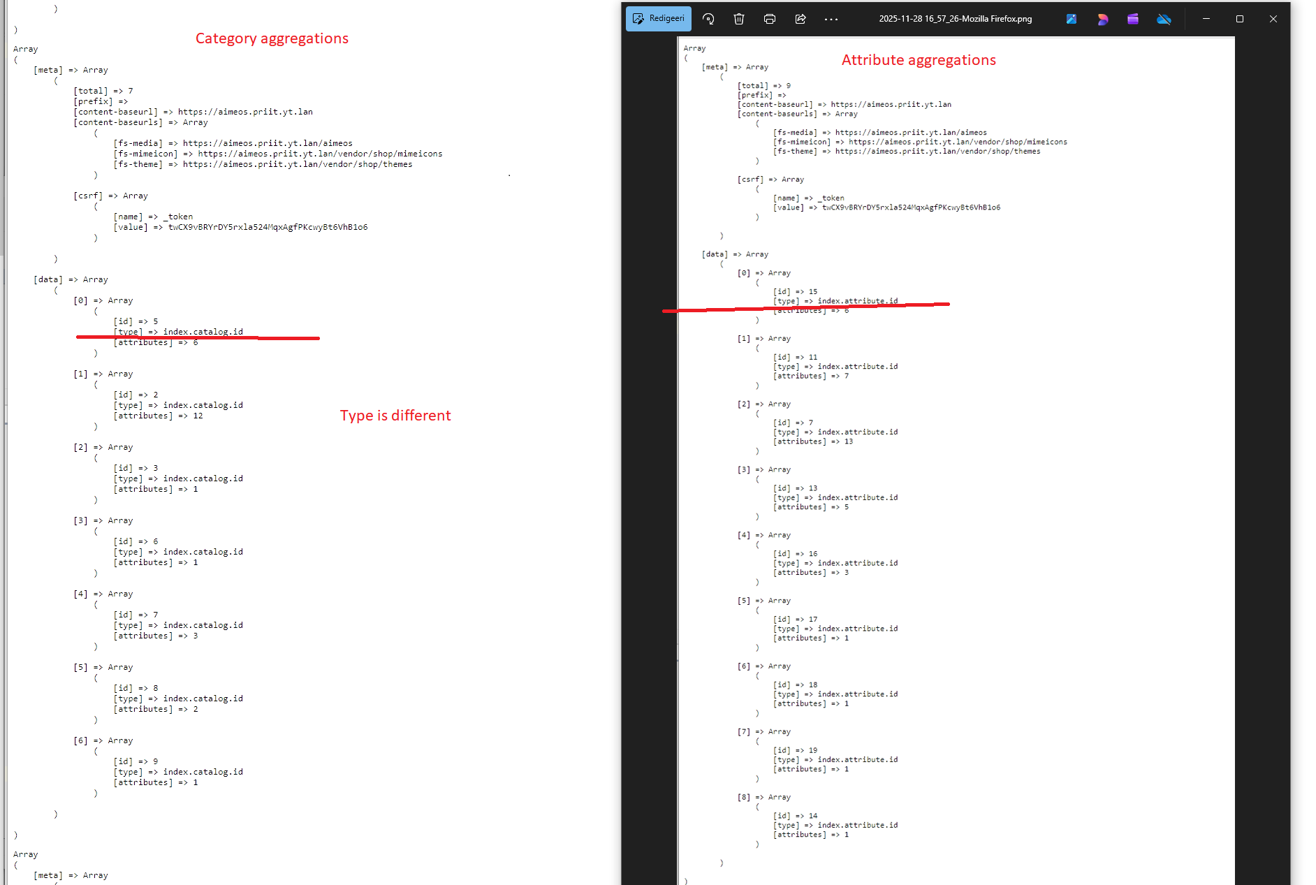

Combining aggregations like this is not possible because the different data would be merged into a single array where you might not know which is included for what reason.
If we talk about combining aggregations, the at first glance I think they can be combined. Each returned result has "type" attribute. Based on that I can easily differentiate them.
Here is the picture:

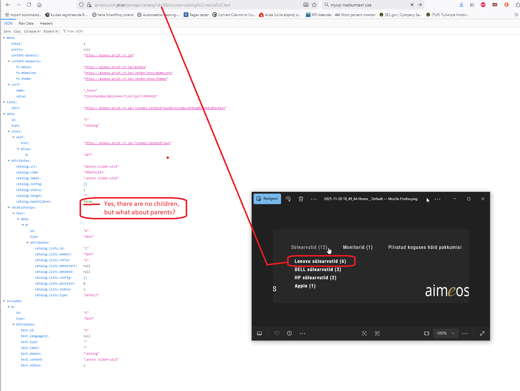

I am working with categories now and already I have a question.
https://aimeos.priit.yt.lan/jsonapi/catalog?id=5&include=catalog%2Cmedia%2Ctext
Consider this picture as a response to the URL above:
I can clearly see that the category "Lenovo sülearvutid" has no children. But what about parents? On Magento there is a "path" column for the catalog_category_entity database table (example value: 0/2/5) from which I can easily locate the parents. Do you have something similar on the API too?
I need this information so I could build out the breadcrumbs.
On Aimeos default application breadcrumbs work as long as the customer is under category view, but once product view is opened, the breadcrumb does not work.
It did not work on default Magento 2 too, but I have fixed it for some customers and it has brought them more customers as a result of that.
Here is another picture that clarifies what I mean:

matish wrote: 28 Nov 2025, 17:05 I can clearly see that the category "Lenovo sülearvutid" has no children. But what about parents? On Magento there is a "path" column for the catalog_category_entity database table (example value: 0/2/5) from which I can easily locate the parents. Do you have something similar on the API too?
The parent categories are not available explicitely because
- Products can be assigned to multiple categories
- Aimeos doesn't have a "main" category
- Retrieving categries up to the root category can be costly
But you can display the current category by passing the category ID to the product detail view if you fetch the categories for the menu nevertheless. You only have to set the canonical URL correctly to avoid duplicate content.

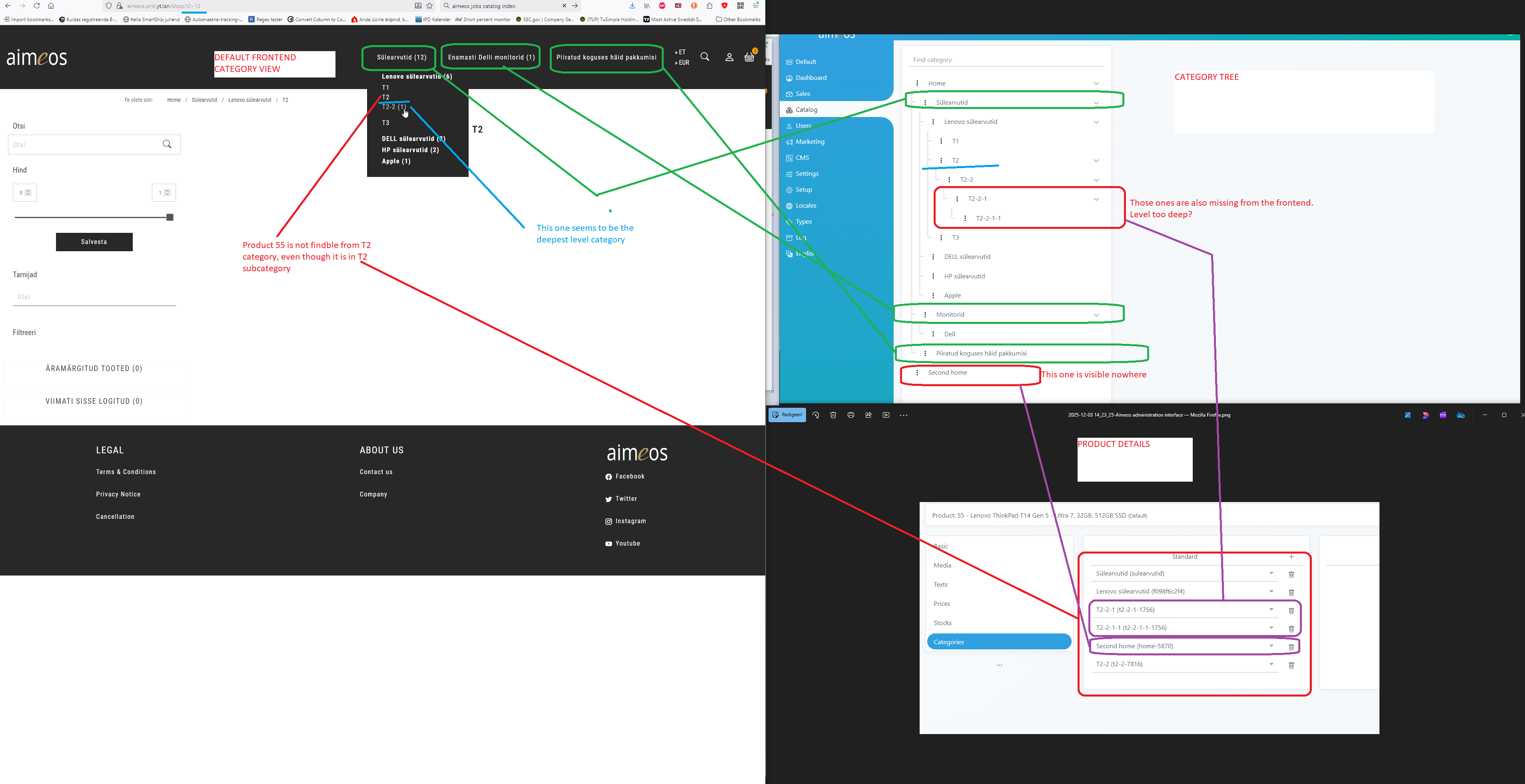

Playing around categories revealed that Aimeos category rendering is different from my expectations.
First of all, there is no way to access "Second home" category over the API.
Initial starting point:
https://aimeos.priit.yt.lan/jsonapi/catalog?include=catalog%2Cmedia%2Ctext

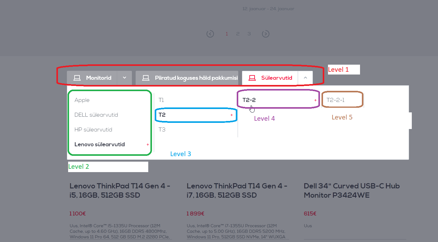

Secondly, categories deeper than level 4 are never loaded. (Over the API I managed to get all levels, except for the "Second home" category)
And thirdly, if there is a product available in subcategory (like T2-2-1) and customer is viewing its direct parent (like T2-2) then this product is not findable in it. On Magento this behaviour is different via "is_anchor" attribute.
Picture:
For now you can consider those findings as information. Those things do not affect my development, except for the third issue, that affects category view implementation when certain category is chosen. I guess one way is to supply ID-s of all subcategories with OR condition, but I may need to index that separately.
