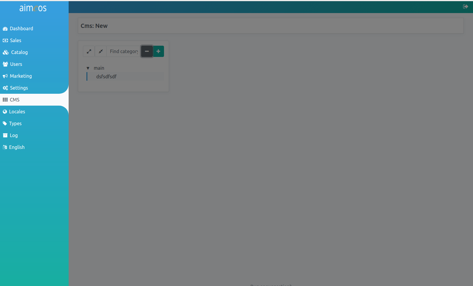

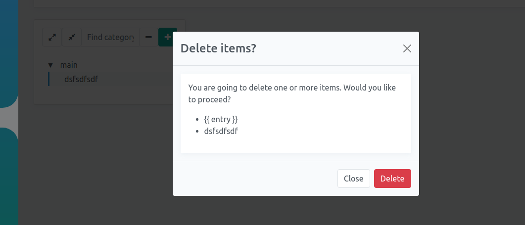

I work on cms tree and by the way delete item from tree not working. Screen just got grey. Modal is not opened.
This might be the fix
And also seems vue has not rendered items
$('#confirm-delete > div').modal('show')- Attachments
- Screenshot from 2021-02-11 14-50-04.png (29.4 KiB) Viewed 383288 times
- Screenshot from 2021-02-11 14-42-39.png (51.94 KiB) Viewed 383293 times

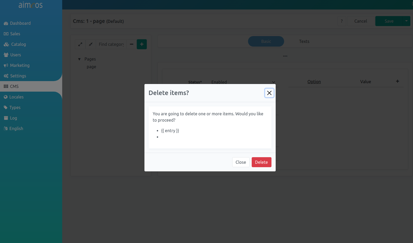

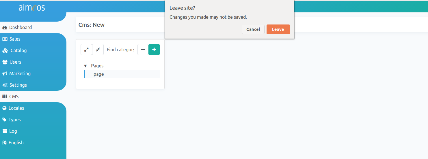

For now there is couple bugs. The first is always appearing alert. And the second is delete modal is not working correctly, close buttons not working and info about deleting items not shown correctly.
I have created pull request, sorry, I don't know if I have done it very well, because I did not use pull requests so often..
- Screenshot from 2021-02-12 23-45-53.png (73.28 KiB) Viewed 383410 times
