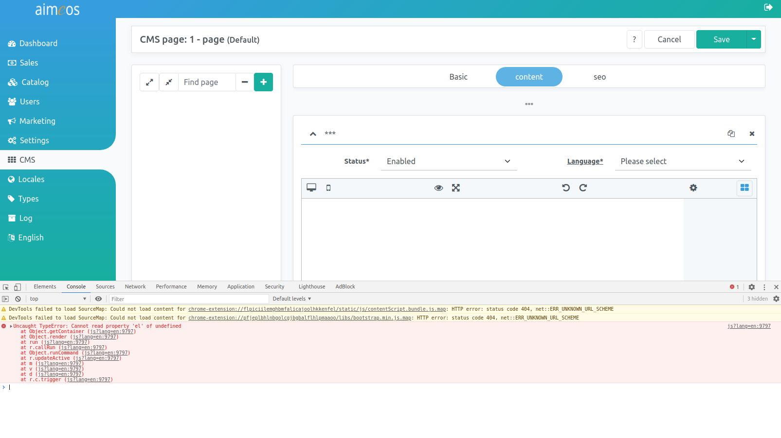

ok, I have updated the components. But when I clicked to add new content item I got JS error
And the page is not displayed in tree (
Seems tree is not implemented yet ?
JS error seems related to this file
https://github.com/aimeos/ai-cms-grapes ... /custom.js
line 199,
I will try to fix JS grapejs error with my custom extension, but why the editor looks such empty ? I thought there should be more functions etc )
line 199,

}- Attachments
- Screenshot from 2021-02-24 15-46-12.png (135.08 KiB) Viewed 390993 times

Tried on a fresh installation with aimeos/ai-cms-grapesjs:dev-master and it works without any JS error. The error causes that the panels on the right are not displaed.MikaelNazarenko wrote: ↑24 Feb 2021, 13:48 ok, I have updated the components. But when I clicked to add new content item I got JS error
