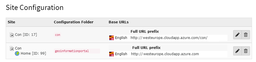

JariVäätäinen
Posts: 10
Joined: 20 Nov 2019, 14:13
Re: Scheduler problem
Post by JariVäätäinen » 25 Nov 2019, 09:22
Below are attached my site tree and site configuration. The problem may be that the web store is located in a different branch of the directory tree than the root file and Aimeos Scheduler tries to find it from the rootline (https://github.com/aimeos/aimeos-typo3/ ... r/Base.php)?
How can I tell Aimeos that the root page of the web site is Home and the webshop doesn't have own root page?
Best Regards,
Jari
Posts: 8746
Post by aimeos » 26 Nov 2019, 20:44
Yes, that won't work. You need to move the "Webshop" page tree below "Home" or make it a root site on its own (so it has a globe too).
