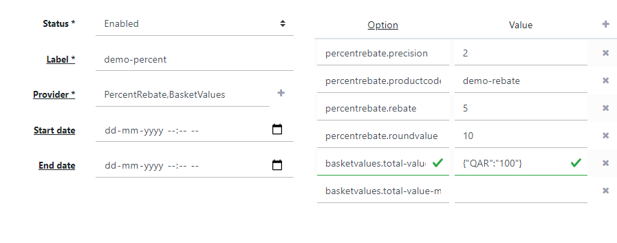

We are using JSON api into mobile application. Now, we are checking for voucher type : Percent Rebate.
But, In that, when we add additional flag related to basket values. Then it is not working. Even if we reached to basket max amount into basket total and apply percent rebate voucher code. it is showing discount value 0 all time.
On the other case, when we remove basket values from percent rebate then it is working fine. So, we need to know that either this basket values is supported with percent rebate or not at the moment?

Can you please post a screenshot of your configuration?

yes, File attached

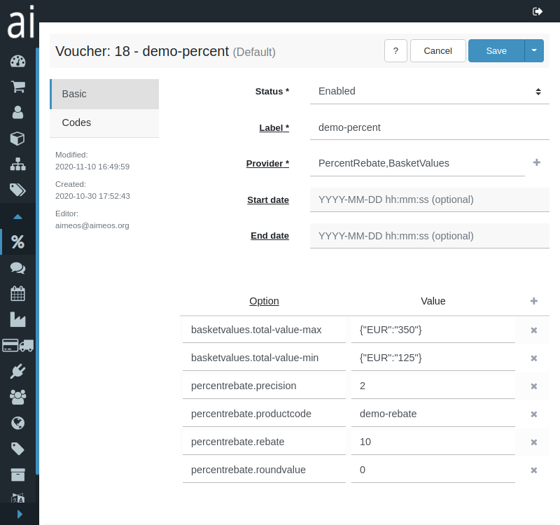

This configuration works well in the HTML frontend if the basket value is between 125 and 350 EUR so I guess it works for the JSON API too:
Check if the coupon is part of the basket in the JSON response.
