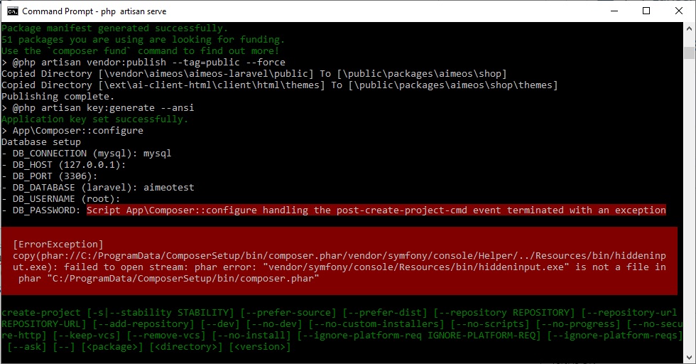

I have just installed aimeo shop from https://github.com/aimeos for testing.
The version is 2020.10.3
PHP Version I am using is 7.2.10
The package successfully downloaded but when asked for Database credentials I got this error :
Please help how to fix this.

Which composer version do you use? You can check with:
composer -V

Composer version is 2.0.3

This is a bug in composer fixed by:
https://github.com/composer/composer/issues/9421
You need composer 2.0.6 by executing:
composer self-update

Thanks. This fixed the issue and I was able to install.
