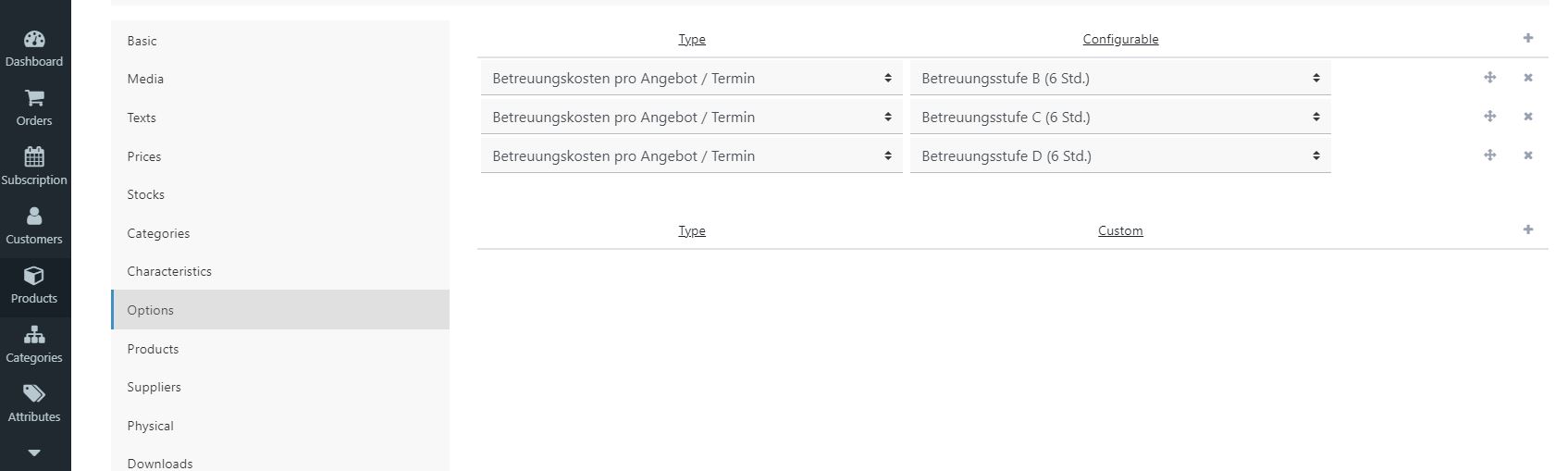

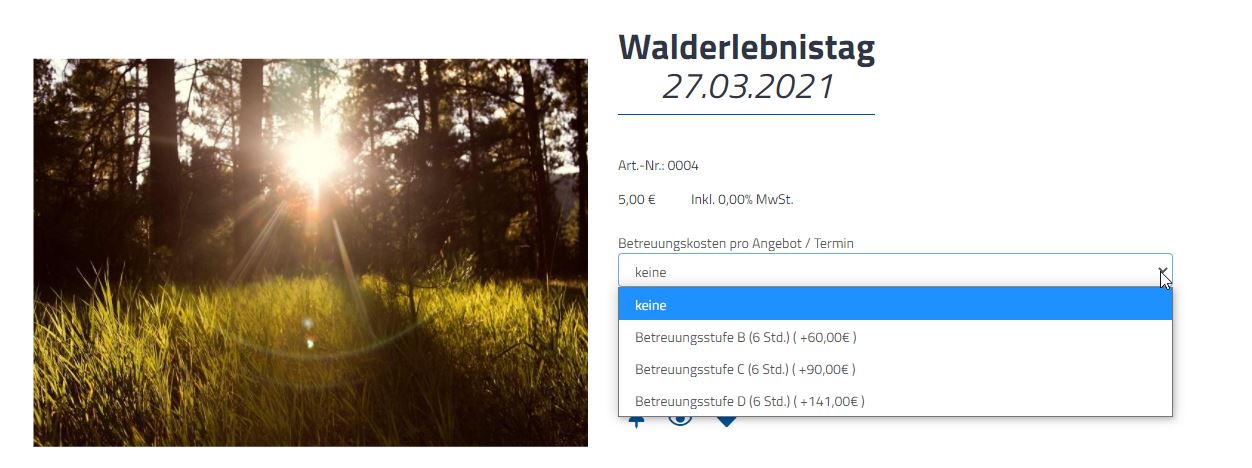

i have different attributes of my own attribute type.
These are assigned to the product (event) as options.
In the shop, the options are also displayed for selection.
Can I define this selection as a mandatory field?
Best regards
Sven

Re: Options as required field
You can set the "preselect" option for your attribute type and then, it's mandatory:
https://aimeos.org/docs/2020.x/config/c ... #preselect
For variant attributes it's:
