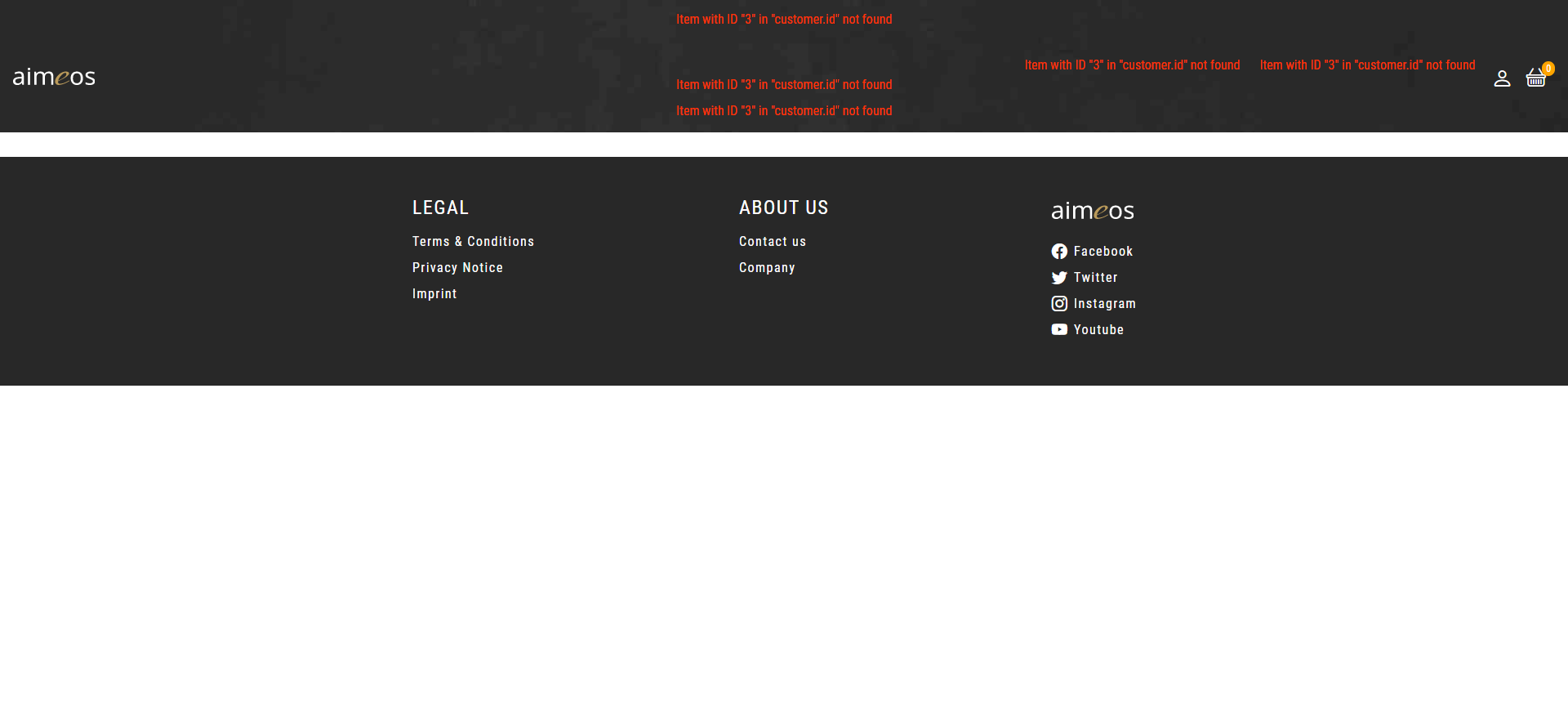

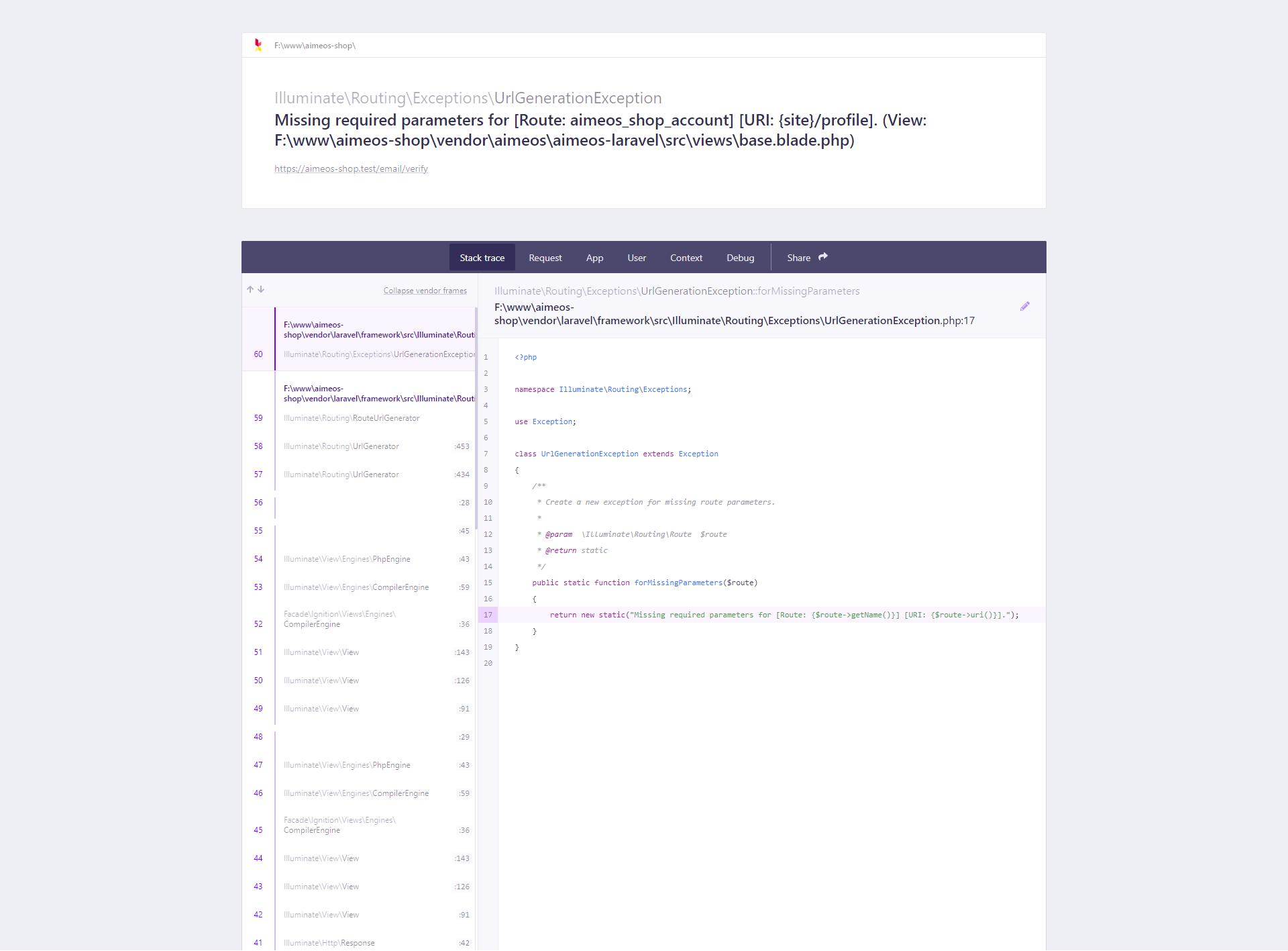

I have installed fresh aimoes setup and enabled SHOP_MULTISHOP and SHOP_REGISTRATION variable to .env .
however, when I try to register I m getting an error
Missing required parameters for [Route: aimeos_shop_account] [URI: {site}/profile] (see attachment)
if I login after the exception with the same credentials it works but I get "Item with ID "3" in "customer.id" not found"

- screenshot-aimeos-shop.test-2021.08.13-18_16_54.png (190.56 KiB) Viewed 3474 times
- screenshot-aimeos-shop.test-2021.08.13-18_17_52.png (83.84 KiB) Viewed 3474 times
Re: How to setup aimoes for Multishop
Thanks for your report. There's something wrong with the parameters handover and we will check and fix the problem.
Can you please adapt your composer.json file, use aimeos/aimeos-laravel "2021.7.x-dev" there and run "composer up" afterwards? This will fix the error messages in the frontend.
