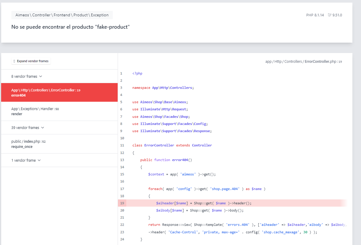

- PedroLópezAndradas
- Posts: 22
- Joined: 16 Jan 2023, 11:30
Re: How to return 404 status if an item is not found?
With 2022 package, when the url does not match a product, it throws an exception.
Finally, ¿did you set an option to return a 404 page instead a 500?
Thanks!
