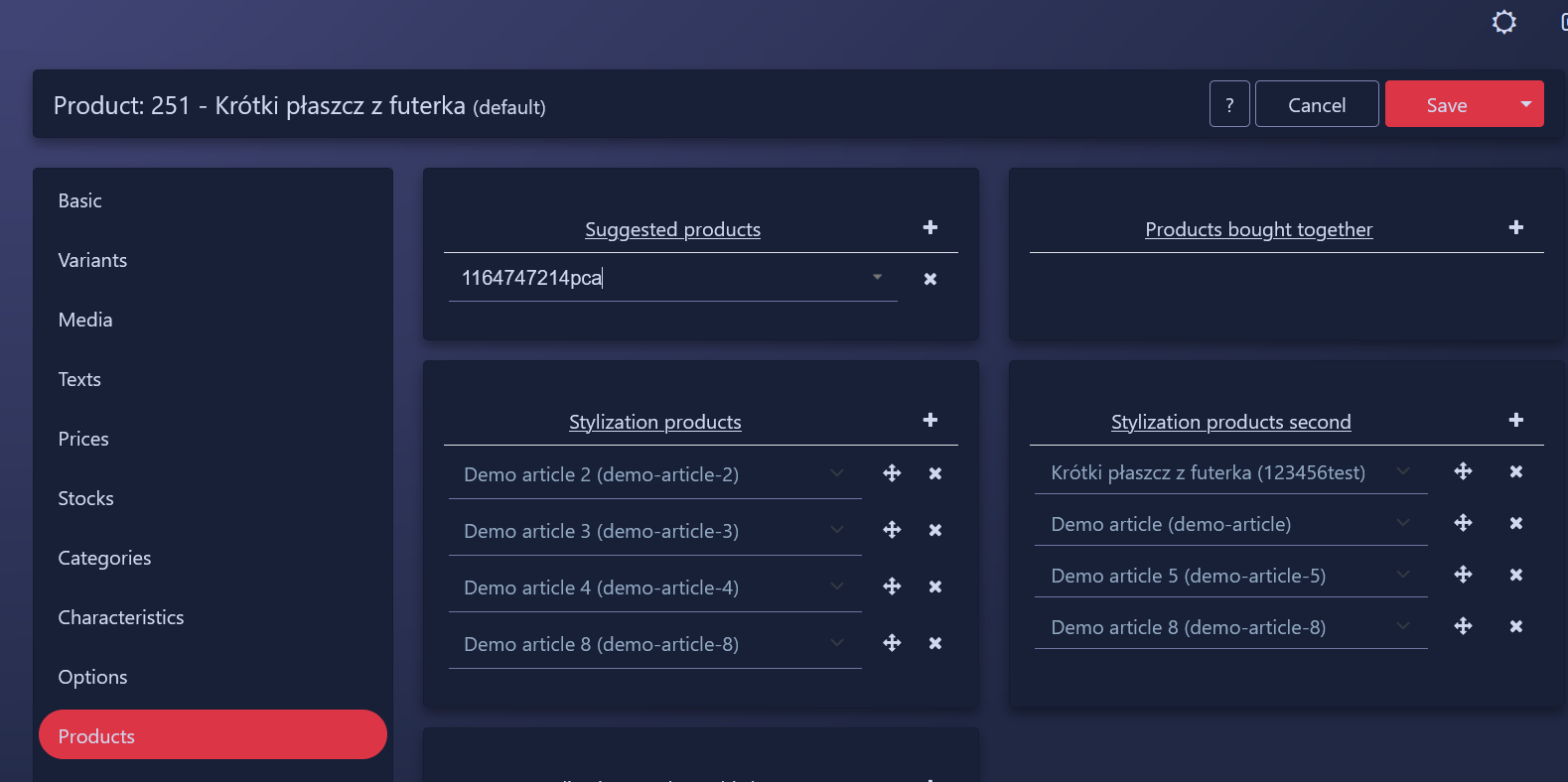

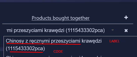

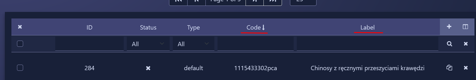

In the product catalog in the admin panel, we have column CODE. While importing products using CSV in Suggested products by CODE everything works fine. But when I try to add products manually, I cannot use CODE but only LABEL.
Is it possible to add products not by LABEL?

the product catalog contains a large number of products (more than 250,000).
some SELECT-type products contain additional products that can be added to the Suggested products, Products bought together and Stylization blocks (made for an online store). To add products to these areas, you can use LABEL (or drop down list)or CODE (when importing products using CSV). the question is to be able to add products not by LABEL but by CODE it doesn't work that way
