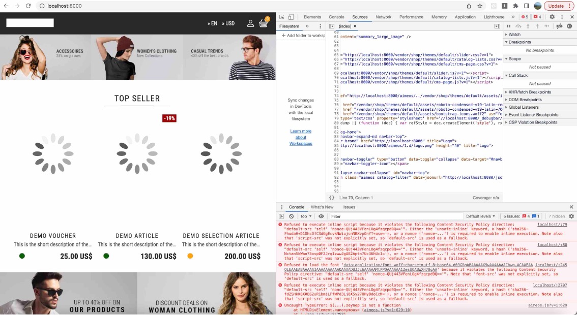

After installing barryvdh (a PHP debug bar for Laravel), I can see the following errors as attached ("APP_DEBUG=true" in ".ENV"):
1. The product images cannot be downloaded.
2. The debug bar is not shown properly. (The console log shows some clue about it, but I don't understand what they mean. I need a help on this! FYI, on login/register pages, I can see the debug bar properly.)

The DebugBar implementation uses inline Javascript, which conflicts with the strict Content Security Policy in the Aimeos base Blade template. We've changed that so the CSP is only applied in non-debug mode and you can test yourself by executing:
composer req aimeos/aimeos-laravel:2022.04.x-dev

Thank you for your help! I've tried to run your command in the terminal but I've got this error message:
There are no commands defined in the "aimeos/aimeos-laravel" namespace.
Could you let me know what's worng with it?
Posts: 8625
Re: Error after installing barryvdh (PHP debug bar for Laravel)
Post by aimeos » 30 Jun 2022, 09:35
Sorry, it must be:
daybyday
Posts: 4
Joined: 23 Jun 2022, 09:29
Post by daybyday » 30 Jun 2022, 14:46
It works now! Thank you!
