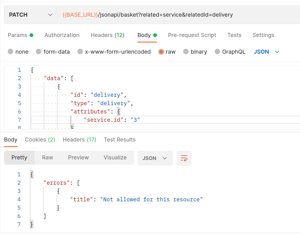

Good evening, your work on aimeos jsonapi is quite good. I've been using it for almost a month.
But when I want to change the service data in basket I get that I am not allowed to do that. For convenience, I request to add a feature to be able to update the service (payment/delivery) data in basket. Thank you for your availability
Screenshot from 2022-06-30 17-14-57.png (10.96 KiB) Viewed 7748 times

Which request are you sending to the API (request URL and body)?

url: {{BASE_URL}}/jsonapi/basket?related=service&relatedid=delivery
method: PATCH
body: {
"data": {
"id": "delivery",
"type": "delivery",
"attributes": {
"service.id": "3"
Posts: 8746
Re: Request for new feature
Post by aimeos » 30 Jun 2022, 12:56
Should be possible but need to remove and add the delivery service again here:
https://github.com/aimeos/ai-client-jso ... andard.php
Are you able to create a pull request with the necessary code?

Because Aimeos supports multiple delivery and payment options per basket, the PATCH request may also look like:
method: PATCH
body: {
	"data": [{
		"id": "delivery",
		"type": "delivery",
		"attributes": {
			"service.id": "3"
The difference is the list ([{...}]) of options to pass but this can be optional.

Post by thisisbintang » 30 Jun 2022, 16:04
still not working
Screenshot from 2022-06-30 23-04-17.png (61.34 KiB) Viewed 7585 times

Post by thisisbintang » 30 Jun 2022, 16:05
i forgot to show body request
Screenshot from 2022-06-30 23-05-18.png (75.3 KiB) Viewed 7585 times

Support for PATCH method for basket services is now available in aimeos/ai-client-jsonapi:dev-master and will be part of the 2022.07 release:
https://aimeos.org/docs/master/frontend ... e-services
