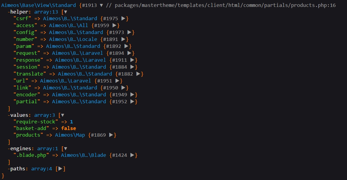

$this contains many things

If you have an Aimeos view, "$this" is always available in the Aimeos template because it's the view object itself. If it's a Blade view, then you don't have any Aimeos view helpers and only the Laravel Blade directives are available.
