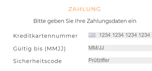

But now it looks far more better than the vanilla ominpay/stripe form inputs:
Regards
