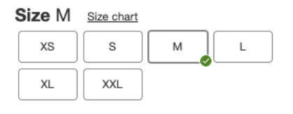

Hi, community.
I am currently implementing a shop that sells gears and some products have many sizes such as (XS, S, M, L, XL, XXL). I am confused if product type "select" would be an option and just add a variant of the same product with each of the sizes. Would this approach be effective, or are there better alternatives for managing product variations?
Screenshot 2024-08-20 at 11.29.02 PM.png (17.73 KiB) Viewed 15075 times

Create a selection product with six variant articles and assign each variant article another size attribute.
