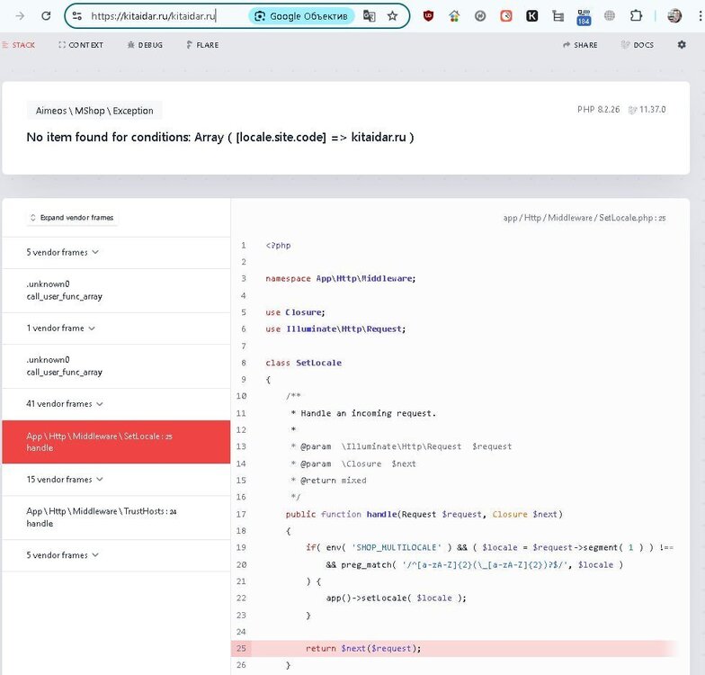

Re: Can't redirect the 'default' page to the main page site.com
I have two tasks in this section:
1) on the main (home) page of the site, only the domain of the 2nd level (kitaidar.ru) should be displayed in the address without specifying the store's default address;
2) each new store must be transferred to its own level 3 domain (store1.kitaidar.ru)
I'm doing something wrong. According to your recommendation, I have made changes to "/myshop/config/shop.php":
This is my "/myshop/routes/web.php":
When trying to open the main page kitaidar.ru returns an error and the address string becomes "https://kitaidar.ru/kitaidar.ru ":
Please push me in the right direction to resolve the issue.

'site' => 'kitaidar.ru', // used instead of "default"

As you have enabled SHOP_MULTISHOP, you need to change the first route block within the if-condition. The second one will be overwritten when enabling this config setting.
If configured correctly, you have to change the site codes of the shop accordingly to:
- kitaidar.ru
- store1.kitaidar.ru
Another option is to use sub-domain routing:
In that case, the site codes must be:
- www (you need a sub-domain for your main domain too)
- store1
Then, your stores will be available at www.kitaidar.ru and store1.kitaidar.ru
- kitaidar.ru

It still doesn't work.

This is certainly true: I need to understand the structure of routing stores to the appropriate level 3 domains.SHOP_MULTISHOP enabled several stores in one installation.
In the server settings themselves, I pointed to the internal directory, otherwise I would not have been able to open the main page (with the "default" store address) - everything works for me after installation, but the store address is added after the main domain (kitaidar.ru/store_N ).
I did everything according to the instructions:
1) add "'domain' => '{site}.kitaidar.ru'," to "/myshop/config/shop.php":
<?php
$multishop = $multiroute = [];
$prefix = env( 'SHOP_MULTILOCALE' ) ? '{locale}/' : '';
if( env( 'SHOP_MULTISHOP' ) ) {
$multishop = ['routes' => [
'admin' => ['domain' => '{site}.kitaidar.ru', 'prefix' => 'admin', 'middleware' => ['web']],
'jqadm' => ['domain' => '{site}.kitaidar.ru', 'prefix' => 'admin/{site}/jqadm', 'middleware' => ['web', 'auth', 'verified']],
'graphql' => ['domain' => '{site}.kitaidar.ru', 'prefix' => 'admin/{site}/graphql', 'middleware' => ['web', 'auth', 'verified']],
'jsonadm' => ['domain' => '{site}.kitaidar.ru', 'prefix' => 'admin/{site}/jsonadm', 'middleware' => ['web', 'auth', 'verified']],
'jsonapi' => ['domain' => '{site}.kitaidar.ru', 'prefix' => '{site}/jsonapi', 'middleware' => ['web', 'api']],
'account' => ['domain' => '{site}.kitaidar.ru', 'prefix' => $prefix . '{site}/profile', 'middleware' => ['web', 'auth', 'verified']],
'default' => ['domain' => '{site}.kitaidar.ru', 'prefix' => $prefix . '{site}/shop', 'middleware' => ['web']],
'basket' => ['domain' => '{site}.kitaidar.ru', 'prefix' => $prefix . '{site}/shop', 'middleware' => ['web']],
'checkout' => ['domain' => '{site}.kitaidar.ru', 'prefix' => $prefix . '{site}/shop', 'middleware' => ['web']],
'confirm' => ['domain' => '{site}.kitaidar.ru', 'prefix' => $prefix . '{site}/shop', 'middleware' => ['web']],
'supplier' => ['domain' => '{site}.kitaidar.ru', 'prefix' => $prefix . '{site}/s', 'middleware' => ['web']],
'page' => ['domain' => '{site}.kitaidar.ru', 'prefix' => $prefix . '{site}/p', 'middleware' => ['web']],
'home' => ['domain' => '{site}.kitaidar.ru', 'prefix' => $prefix . '{site}', 'middleware' => ['web']],
'update' => ['domain' => '{site}.kitaidar.ru'],
}Code: Select all
'mshop' => [
'locale' => [
Аccording to your instructions, you also need to add routing in the file "routes/web/php":

subdomain: vendor1.yourdomain.com
Route::group(['domain' => '{site}.kitaidar.ru', 'middleware' => ['web']], function () {
Route::get('/', '\Aimeos\Shop\Controller\CatalogController@homeAction')
->name('aimeos_home')->where( ['site' => '[a-z0-9\-]+'] );
I think my error at this wep.php file, please help me write right routing rules, this is importand to me to understand this alhgoritm.

Like said, when you use sub-domain routing, your main site must be www.kitaidar.ru and your web site is only available by www.kitaidar.ru and NOT kitaidar.ru. Use domain based routing if you want to be free what domains your marketplace and stores are using.

I understand why it don't work at my server - I use the HestiyaCP control panel, and on it I need to configure the domain system separately. Will learn hestia's documentations and when will write when can find solution of proublem with redirect to subdomains. https://hestiacp.com/docs/user-guide/dns.html
