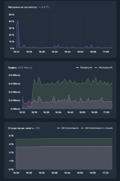

At first time something start work (I see it by "top" and memory usage at Server #2)

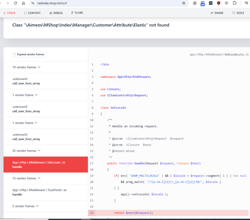

and after command "php artisan aimeos:setup" frontview of site is not working:
at admin I can enter, but there are no any items and sites:
if I start command: "php artisan aimeos:setup --option=setup/default/demo:1" , then write error:
at elasticserver (Server #2) health is green, at log no errors:
my google search give me no results.

Seems like your ES server (10.0.0.2:9200) is not reachable from 10.0.0.1. Maybe it's a firewall issue.
The error regarding \Aimeos\MShop\Index\Manager\Customer\Attribute\Elastic is strange because that class doesn't exist at all. Your configuration seems to be correct:

2) Here is my configuration file from the Elasticsearch server:

at the time of submitting the command: "php artisan aimeos:setup", the following error is displayed:
At front:
Q#2: need I add this to shop.php too? So, need to add both part?
'es' => [ .....]
'es-stock' => [....]
and es-stock need have connection data to elastic again? At one shop.php file two connection with elasticsearch parameters at each?

This is your error:
  'es' => [
        'hosts' => [
            '194.87.220.222/:9200',
It must be:
  'es' => [
        'hosts' => [
            '194.87.220.222:9200',
The slash (/) is wrong and leads to not connecting to port 9200. The ElasticSearch server should be close to your web server in terms of latency. If they are far away, it increases the round trip time for the requests and slows down you shop.
ЕвгенияСемихова(ИПСемиховаЕ.А.)
Posts: 70
Joined: 11 Jan 2025, 09:45
Re: How to install gigacommerce (Elasticsearch) at second server
Post by ЕвгенияСемихова(ИПСемиховаЕ.А.) » 11 Feb 2025, 10:52
I think my error was at "/" in shop.php:
Now "php artisan aimeos:setup" was finish without errors and site is working good. Need to understand how I can check all - is this the finish for connection gigacommerce?
UPD: yes, error was at "/", thanks
Dear Aimeos, how I can check it? By URL? By logs at Elasticsearch server?

Post by ЕвгенияСемихова(ИПСемиховаЕ.А.) » 11 Feb 2025, 11:00
dear, I understand that. At first test time I work for my own errors and expirience. Step by step I write my own instruction. And then I'll build ideal system.
also have some questions about working scheme, if you not angry - can I ask from time to time?

Posts: 8738
Post by aimeos » 11 Feb 2025, 11:08
ЕвгенияСемихова(ИПСемиховаЕ.А.) wrote: 11 Feb 2025, 10:52 Need to understand how I can check all - is this the finish for connection gigacommerce?
To test connection latency, you can use the ping command from the CLI.
