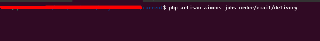

I noticed that my command "php artisan aimeos:jobs order/email/delivery" hangs in the command line.
Surprisingly, it works successfully on the local machine.
What could be the reason?
By experimenting, I found out that the code hangs on the line
"aimeos-laravel/src/Command/AbstractCommand.php:90"
$process->wait();

As I wrote above, this applies to ANY JOB!
However, I looked at the logs. The laravel.log file is clean. There are no errors in the Aimeos admin panel either

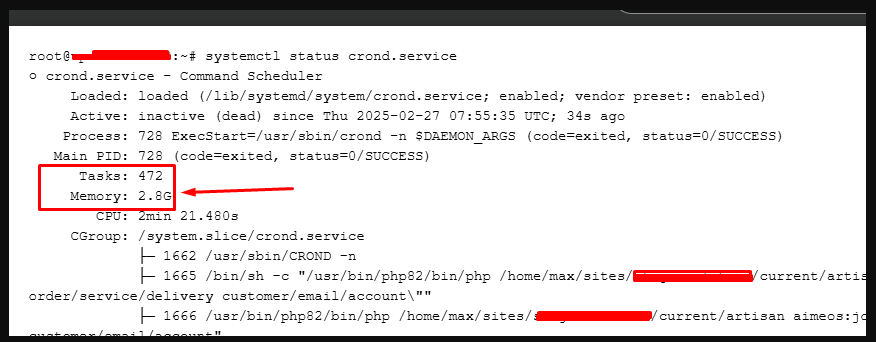

And the code itself is executed. That is, emails arrive, an index is created. It depends somewhere on the final.

Then I get an error that the memory is out
