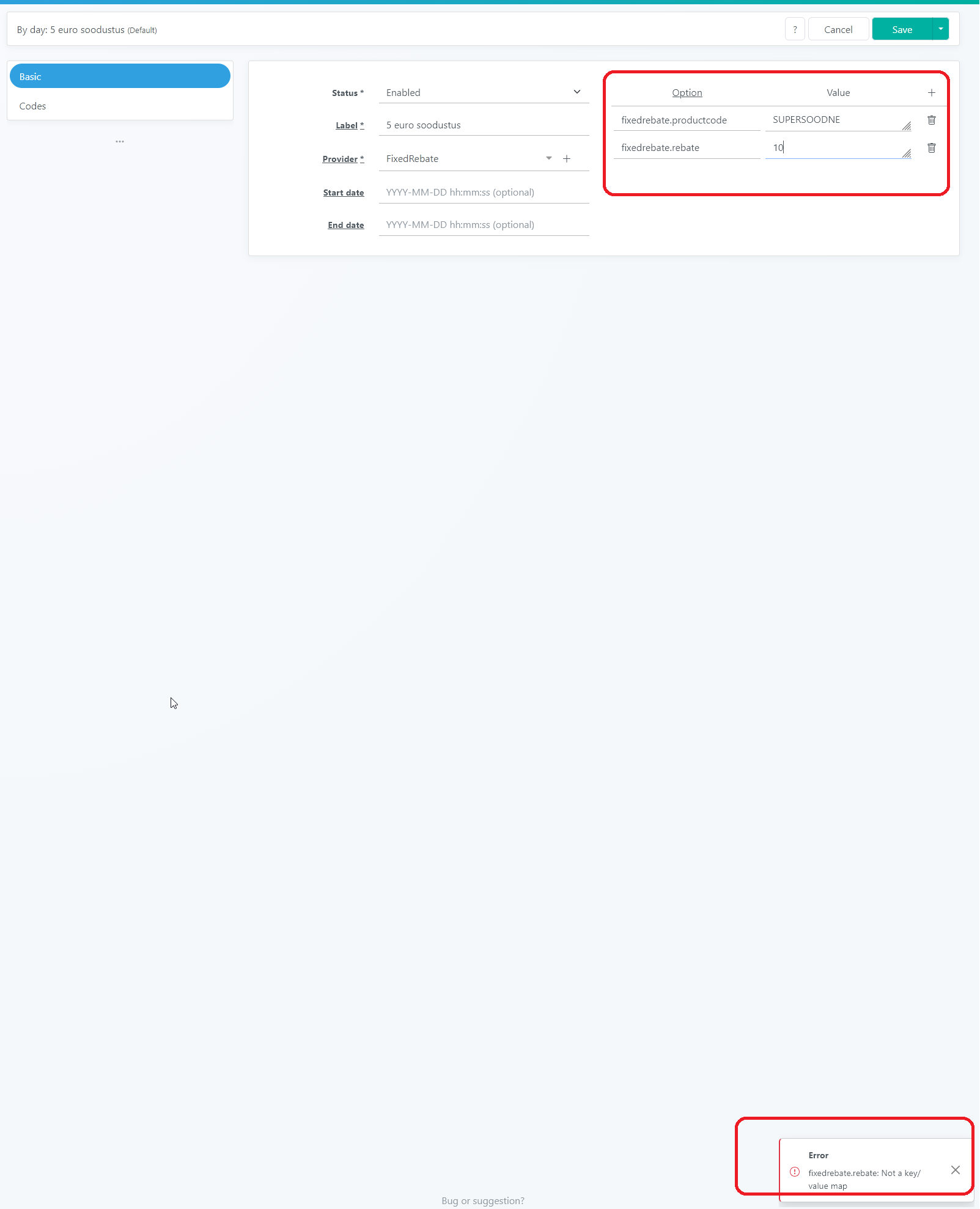

I am trying to handle coupon codes, but unable to create it admin.
I followed this tutorial
https://www.youtube.com/watch?v=b3p3GT7UlBQ
and this:
https://aimeos.org/docs/2025.x/manual/coupon-details/
But I am getting an error that can be seen on the bottom right of the screenshot:
Also I can see in the video that the user entered the rebate value as {"EUR":"10"}, but if I do that, then I get an error saying that the value must be string and not array.
Any link or help so I could get things going again?

The fixed.rebate field is defined as a currency/value map for the admin backend. If you click on the value field, a key/value line and/or a "+" button should appear below. You can see it here:
https://admin.demo.aimeos.org/admin/def ... ?locale=en
You can not enter a value directly into the initial input field as it's only used for displaying the result, e.g.
{"EUR": "10.00"}
If it doesn't work for any reason, check if there's a JS error in the browser console.
