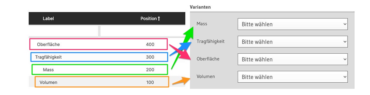

How can variant attributes be sorted individually? I have set the position in the Attribute Types. But this value has no effect.
See attached Screenshot.

Many thanks for the answer. However, my question refers to the Detail view of a product (in the area where a product variant can be selected), not to the Filter.
Is there also a possibility to define the order in the Detail view?

At the moment, the variant attribute types are sorted by attribute type code. You can use codes like "01_volume" so they are sorted accoring to your needs.

In this case there is no possibility to adjust the sorting afterwards? If I change the code of the attribute, all links in the products are lost.
Where would the code need to be adjusted?

You can adapt the code here:
