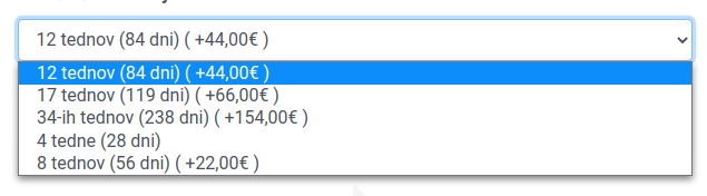

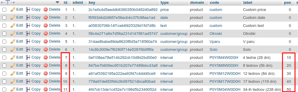

Hello!
I have one problem with attribute sorting by position or id!
ID and pos (in db) is correct, but on frontend attributes have incorrect position!
Screenshot in attachment!
Best regards,
Goran

What's the sorting in the attribute subpanel of the product?

in frontend sorting is incorrect!

Re: Attribute sorting [SOLVED]
Post by aimeos » 24 Dec 2020, 09:07
The attributes are sorted by the order you have added them in the product detail panel of the admin backend, not by the position of the attributes themselves. Thus, you can have a different sorting for different products.
