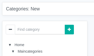

I noticed that the main problem is in having a space in the category name.
F.e.:
Label = Main categories, breaks the navigation on mobile.
Renaming: Label = Maincategories, and it works like a charm.
This behaviour is also mentioned here:
https://github.com/hsynlms/zeynepjs/issues/11
F.e.:
- Screenshot from 2021-07-13 16-00-21.png (9.75 KiB) Viewed 17756 times

Re: zeynepjs mobile-first navigation menu
This should circumvent the problem.
It certainly does, just tried it.
Thank you!!!
