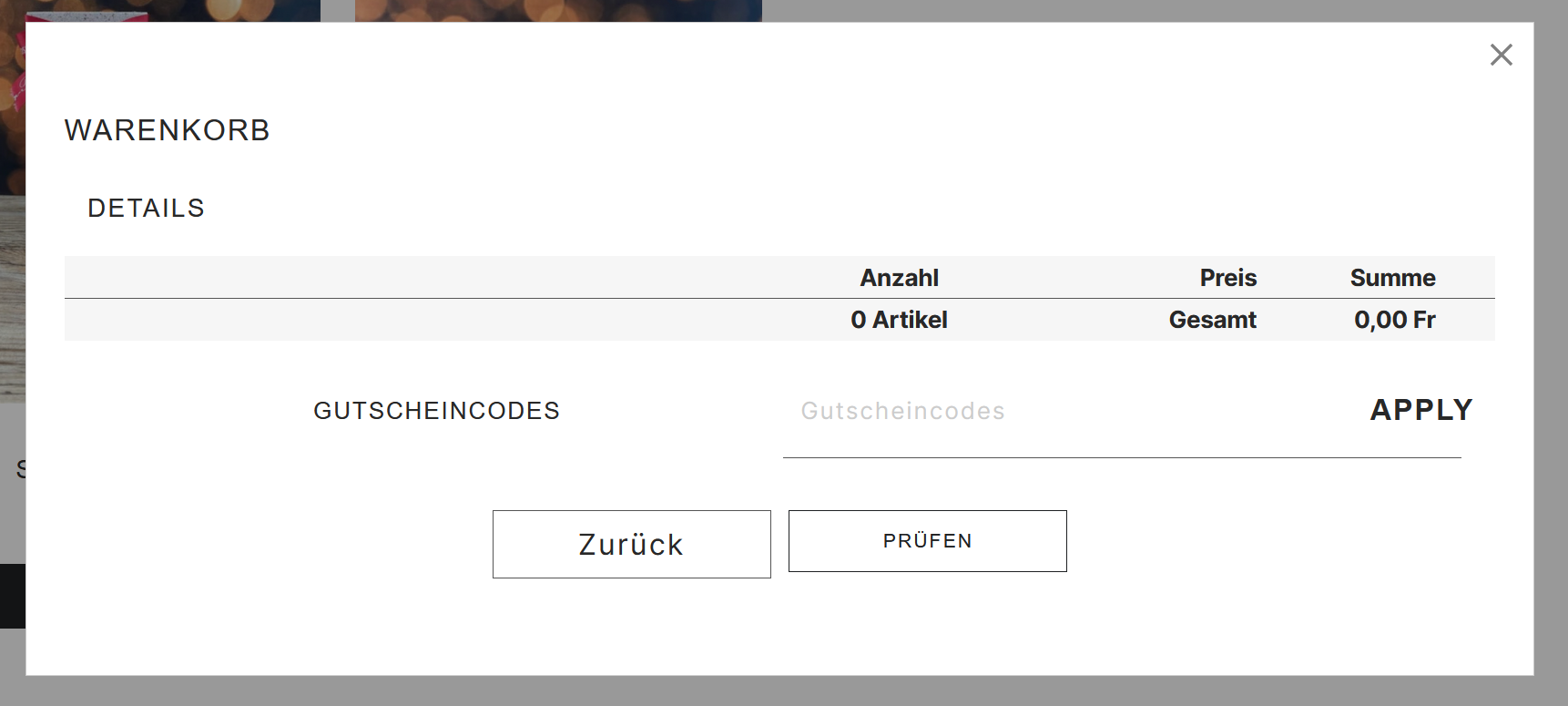

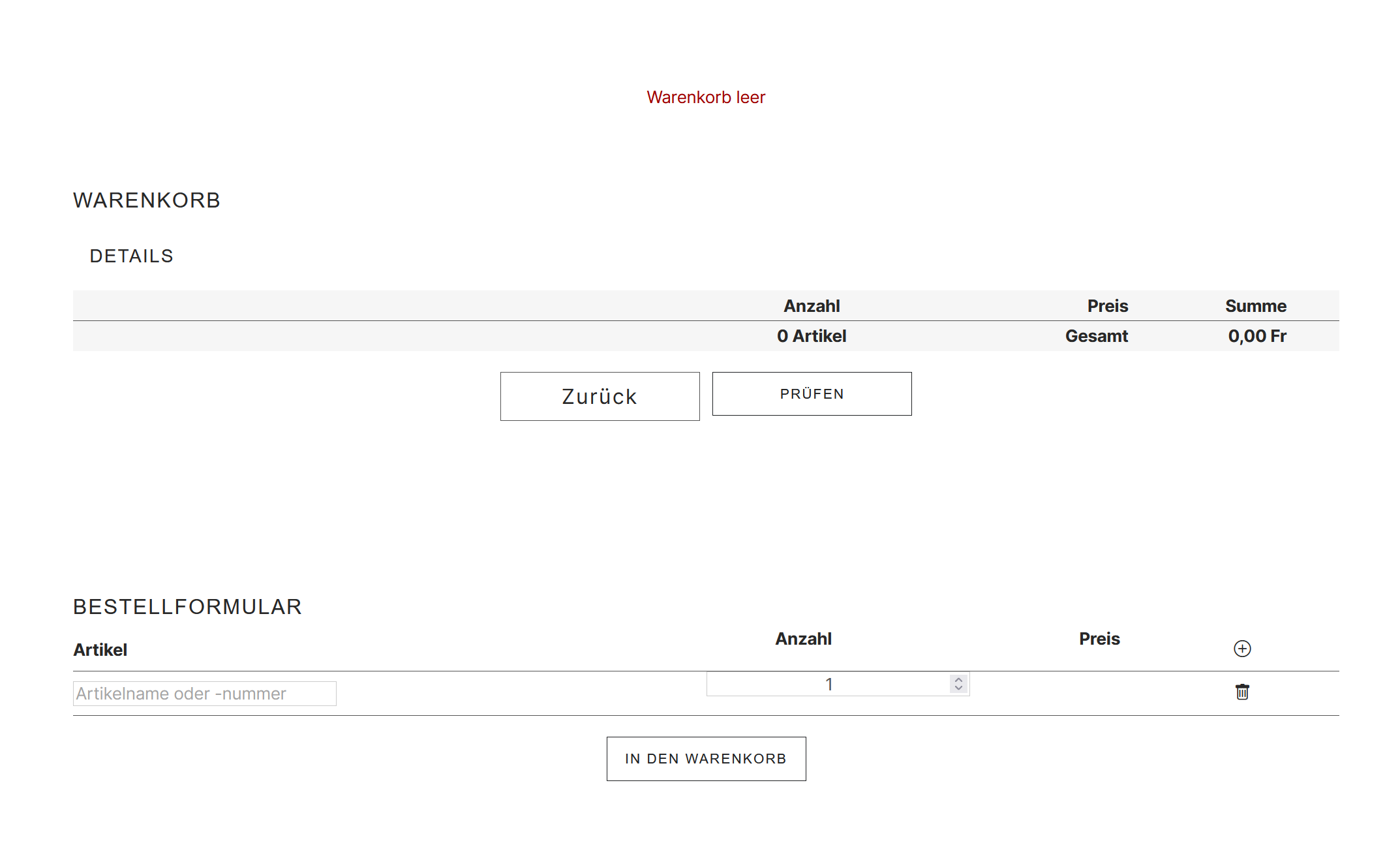

products cannot be added to basket, and there is no error message in JS console. The modal opens but no product is added. And the basket is empty, too.
What could that be?

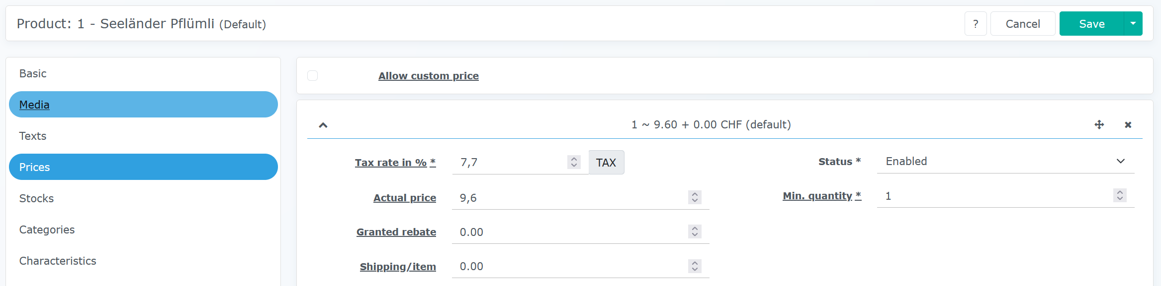

Now, I have 22.4.4 but it still doesn't work.
Screenshot of prices is attached.
Re: Add to basket not working
Post by aimeos » 05 Jul 2022, 08:38
We've tested with a fresh composer installation of the Aimeos TYPO3 distribution and all demo products can be added without problem:
https://github.com/aimeos/aimeos-typo3-dist
The problem must be somewhere in your product so please check stock level and categories of that product as well as the passed quantity. Also check in the network tab of the browser console if all data is passed correctly.
