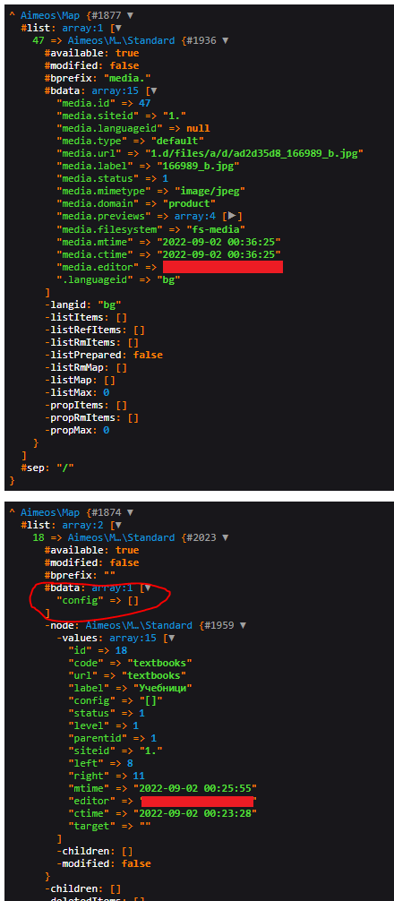

I am trying to output the categories of the products in the following template:
templates/client/html/catalog/detail/body.php
I want them to show in the list of characteristics tab.
How should I go about doing this in my version of aimeos?
I have tried a few methods from this thread, like adding 'catalog' => ['text'] to the domains config, but I either end up with errors or the categories don't show up for the product. I expect the categories to be present somewhere in the $view when I dd($view) in the template.
The latest answer $product->getCatalogItems(); also shows this error in the logs:
Called unknown macro "getCatalogItems" on class "Aimeos\MShop\Product\Item\Standard"
Also the link provided leads to a 404 page.

Post by kdim95 » 02 Sep 2022, 15:17
aimeos wrote: 02 Sep 2022, 14:52 Since 2022.01, you can get the categories using:
$producItem->getRefItems( 'catalog' );
I think this works but should they be appearing under -node?
The other items, for example $mediaItems have them under #bdata.
How do I get them from inside the -node?
By the way, I noticed that I am posting in the wrong forum, I am working with Aimeos Laravel.
