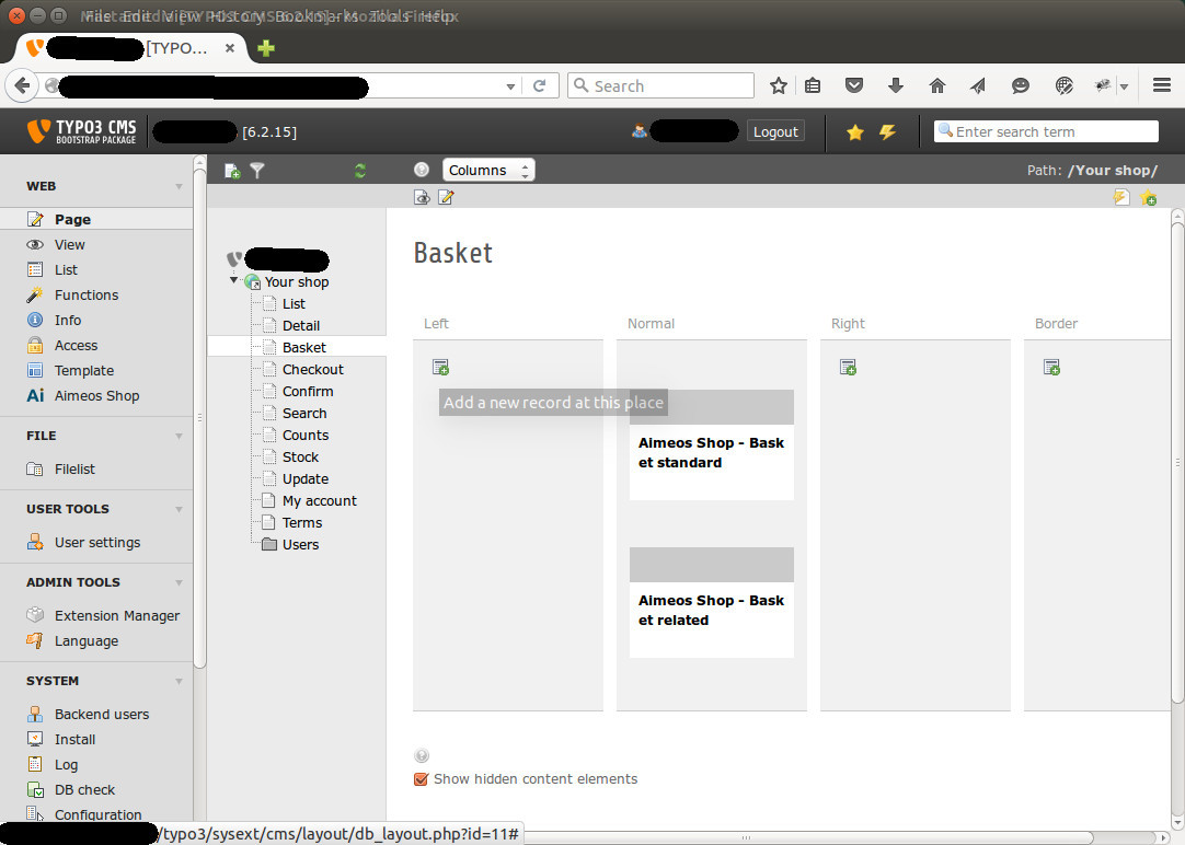

now i installed this version in 2 Typo3 6.2.15 systems for testing. Both of them dont show the content wizard for adding new ce-elements.

Can you post a screen shot of what you mean? I'm unsure of what your are referring to.alpin3rocker wrote: now i installed this version in 2 Typo3 6.2.15 systems for testing. Both of them dont show the content wizard for adding new ce-elements.

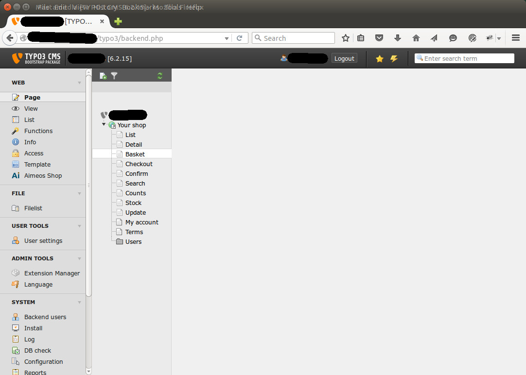

since the version aimeos 2.4.0-dev is installed, it isnt possible to add new content-elements in the content section of Typo3 Backend, with the Wizard. Only in List Modul its possible to add new Elements.aimeos wrote:Can you post a screen shot of what you mean? I'm unsure of what your are referring to.alpin3rocker wrote: now i installed this version in 2 Typo3 6.2.15 systems for testing. Both of them dont show the content wizard for adding new ce-elements.
If Aimeos is deactivated in the Extension Manager it is no problem to add plugins and content...

Tried the same and it works as expected in my installation.alpin3rocker wrote: since the version aimeos 2.4.0-dev is installed, it isnt possible to add new content-elements in the content section of Typo3 Backend, with the Wizard. Only in List Modul its possible to add new Elements.
An empty page is almost always the result of a fatal error. Is there any error message in your Apache error log file (or the TYPO3 log or the madmin_log table)?

Good Morning,
I checked the error.log but no messages about this. It is a shared server i have no access to the apache error log.
Today i made a fresh Typo3 6.2.15 Install with only static_info_tables, real_url, aimeos 2.4.0-dev installed. Generate new page and it is the same behavior. Only in List-Module it is possible to put content in to the content area.
If Aimeos is deactivated in the Extension Manager, all works well.

sorry, i forgot. In Typo3 error log is also nothing to find. The same with madmin_log, i had a look in phpmyadmin, the table is empty.
Re: Scheduler error
Do you use PHP 5.3/5.4 in your environment? Maybe that's the problem that produces the fatal error when you click on the page link.
Without any access to the log where PHP errors are written to this will be hard to find
