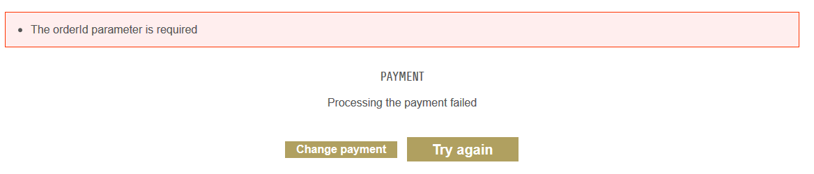

I configured but i have the same error. Any ideas?

Post by aimeos » 19 Jan 2016, 14:20
Bollerx wrote:I configured but i have the same error. Any ideas?
The MobilPay driver expects a non-standard value for the order ID. It used "orderId" instead of "transactionId":
https://github.com/BusinessMastery/omni ... t.php#L226
Maybe you can create a PR the author is willing to merge.
The parameter "details" is also something that is non-standard and will make problems because we don't know what it is and Aimeos won't hand it over.
