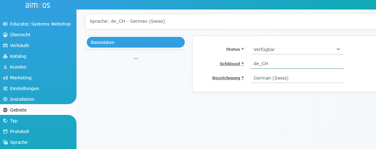

Definig a language in the backend needs the ISO-code in "de_CH" Format. (001.png)

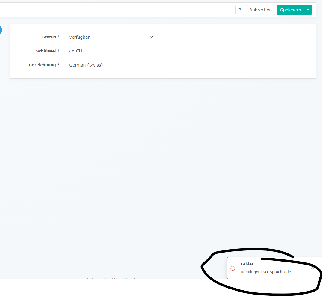

Trying to save it as "de-CH" delivers an error: 002.png

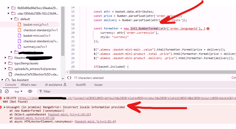

But "de_CH" invokes an error "Incorrect locale information provided" in basket-mini.js (003.png) which might be explainable as https://developer.mozilla.org/en-US/doc ... mberFormat defines ISO-Codes with "-" and not with "_" => "de-CH" instead of "de_CH".
How can I get the basket-mini.js running again with "de_CH" ?

Re: How to define correct ISO-Code?
HTML defines a different separator than the ISO codes. To fix that change the line to:
We've done that in the core files too now.
currency: attr['order.currencyid'].replace(/_/g, '-'),Professional support and custom implementation are available at Aimeos.com
