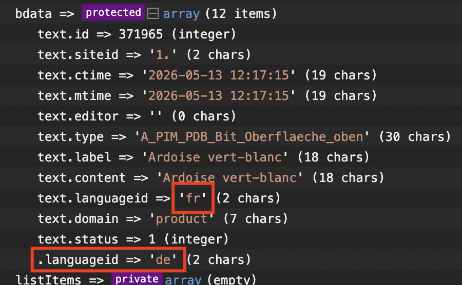

With this code I get ALL languages. Here's an image of a french value but it has a property .languageid = 'de' which seems that there is a check of the language but maybe it's broken or a bug?

And again I get ALL languages of the text attribute listItems as well as this weird property ".languageid" (having the de language as set in locale above) inside the listItem element where all other data starts with "text.XYZ" like in the screenshot of previous post.
Is this intended? How does this work in the e.g. list view of AIMEOS? How does AIMEOS know which language to display for the fields like name, short or long?
At the moment I have to iterate all listItems and check the language by myself
